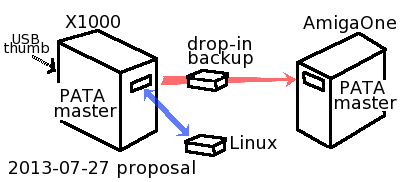

Please take a glance at my proposed setup:
The "backup" master PATA drive does not need to be bootable. It would only have content for use with the AmigaOne.
***WHEN*** I am working on my very limited LINUX project I want to turn off the X1000, remove the removable "backup" PATA drive, put in the LINUX removeable master PATA drive, turn on the X1000, then perform a simple sequence to get to LINUX and start work.
So much for the plan. What is wrong with the plan?

ggw wrote:Please take a glance at my proposed setup:
Interesting Idea, should be quite doable.
Depending on where you are keeping your Linux kernels there are several options.
CFE will see the IDE master drive as ide1.0: and if you partiton it with a MBR you can keep a complete setup on it. Add a boot menu option to boot from it.
If you've stored your Linux files on a cf card all you'll need is the linux dev that it appears as.
As long as you only select that menu item when the Linux disk is installed you shouldn't have any problems.
Be aware however that amigaboot.of - the bit that loads the kickstart will see you AmigaOne HDD, and will respect boot priorities, Make sure you set your SATA drive with a higher boot priority (Media Toolbox)
If you give us a bit more details we should be able to get you sorted out.
