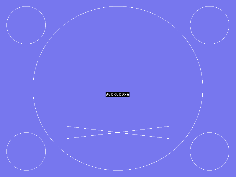

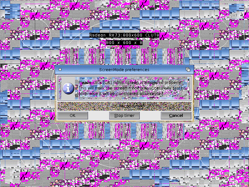

I'm having troubles with my 8 bit screenmodes on my Sam460ex and Radeon HD 4650. I have absolutely no problems with my 16 bit and 32 bit screenmodes but my 8 bits screens usually come up corrupted. Strangely, occasionally my 8 bit screens will look perfectly fine but, more often than not, they're corrupted. I even have the corrupted display issue during the Early Startup Menu. Here are some screen captures:
Screenmodes Pref's Test Screen:
Screenmode test
(104.54 KiB) Downloaded 2626 times
Picasso96Mode Test Screen:
Picasso96Mode

Good suggestion. Tried it, but unfortunately it didn't work. I thought you might have been onto something since, the first time I tired it, it did work. I got some error message about Picasso96 not being able to create screen modes for RV730 (don't know if that's normal or not) but I continued on and everything looked good. Checked Prefs/ScreenMode and all that was there was 6 listings of "P96-0:FakeNative:640 x 480" (all 6 listings were 8bit) and one "BOOTVGA:Productivity" (8bit as well). All tested and displayed correctly.
Unfortunately, upon a system reset, (still booting from CD) the corruption came back. I immediately knew it wasn't working as the console window displaying the above mentioned error message was corrupted. I was able to continue on as before and got to Workbench. Same listings appeared in Prefs/ScreenMode but this time the test displayed them all as corrupted. Here's a screenshot of my Workbench after booting from CD:
BootCD Workbench
BootCD Workbench
