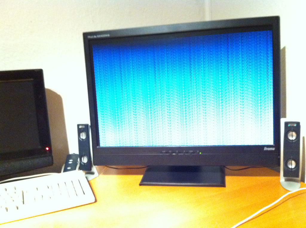

My system is running (graphicscard and SB at the moment) but I think that there is either: Something wrong with my networkcard or it is very incompatible with os 4.1 classic.
The network card is a Dlink DFE-528TX rev. E1. On Elbox homepage it is listed as one of the fast internet cards that should work OTB.
However when it is in the mediator - no matter wich place and combination - my screen is messed up (see attached pic) where it should have shown the OS4.1 boot screen and it goes into a loop :Reset, Radeon on, messed up screen, reset, Radeon off, Radeon on and so on.
All my jumpers are closed.
Anybody else seen this with that kind of card?

Re: Radeon 9200 not recognizes on Mediator 4000Di MKII
Fortunately no
The culprit is the network card. It is incompatible with OS4.1
I have ordered a card with a Realtek 8029 chipset. It is only 10Mps, but as far as I can see on the network speed benchmark here: http://blog.hyperion-entertainment.biz/?p=518 it has some game
