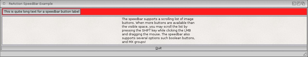

Can one of the OS4 devs/betatesters please confirm this and raise it as a bug? I can confirm the same happens on NetSurf, even if I only have one long-ish titled text button which easily fits in the window, the speedbar.gadget itself sizes itself to fit at least four of these across. In my case, that amount of space is actually wider than the window and even the layout groups it is in fail to constrain it. It has a cascading effect on the rest of the gadgets on the window, which now believe they can size past the window borders!
See screenshot here: http://homepage.ntlworld.com/cdyoung/tm ... barbug.jpg
This is a pretty serious layout defect.

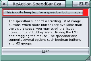

Tested your attach now, and that what i have:
1). With disabled CHILD_MinWidth, 160, (at line 406 in your test-src) i have on running:
(47.32 KiB) Downloaded 2077 times
Any resizing of the window and pressing on the button with wods "This is quite long text for a speedbar button label" do not broken layoyt. So far all seems ok for me there.
2). With enabled CHILD_MinWidth, 160, the default look of window looks like this:
And if i a bit resize it, the text of the button shows:
But no cascades, no overlapping of areas or so. Did that "non-showing button at all" with enabled CHILD_MinWidht, 160 is the error, and button should be shown even if not with all the text ?
As i understand you say about 2 errors: one is that non showing button which just disappear, and another one should show me some layout errors (that one cant find now)

That's not what I get:
When the window opens it resizes to the maximum width available. It's not terribly obvious, but the gadgets are all getting truncated at the window border. If I try to resize it, it only lets me resize it to bigger sizes (bigger than the width of my screen).
What resolution are you running in? Perhaps you need to make the button text longer for the resulting gadget to be wide enough to show the problem?
