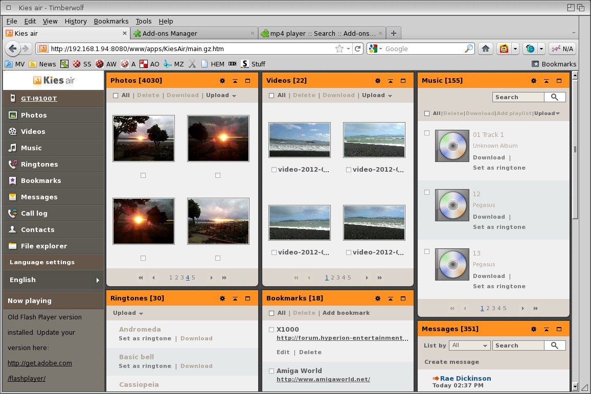

Yes I get the same and it's a feature of the Samsung Mobiles. I have a Samsung SII which is recognised by Amiga OS4 when connected but not automatically available as there are no specific drivers. It does not work with Linux either. However, there is a Samsung Android app called "Kies Air" which allows you to connect to the phone and access all the files and data on the phone.
You just run the app which reports the phones "url" which you can enter into the Timberwolf web browser. The phone then asks your to approve the connection and you have access to all the data on the phone. The attached picture is from my AmigaONE X1000 running Timberwolf, connected to my Samsung II Android phone.

PS You have full access to the file system and you do NOT need to "root" your phone.
