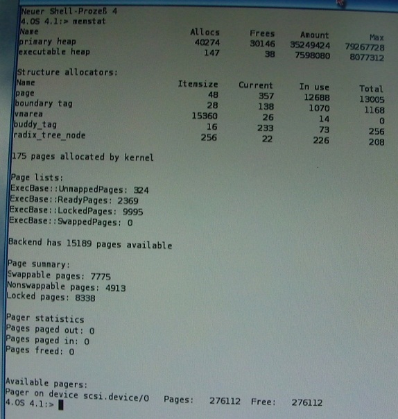

Re: Problems with 256 MB ZorRam
Thanks for the tip!DarrenHD wrote:
If you type memstat in a shell you will be able to see the paging devices that are configured. If the AmigaOS 4.1 kernel has found your ZorRAM then it will be listed by the memstat command.
You can also test by copying more than 128MB of files to RAM:, then run memstat again and you will see your ZorRAM being used.
Attached two pictures, with the data from the shell I can not begin, but I'm too stupid.
My memory is full at 436 MB!
128 MB on the Cyberstorm PPC
256 MB on the ZorRam
but give 384 MB of how to do it, or have I not learned in school really count?
Is there a trick to the right size can be displayed in the title bar?
Yours sincerely,
Mika (Germany)
From your screenshot it seems that the kernel is not detecting the ZorRAM...I only see scsi.device listed, not the ZorRAM. There is no way to add the additional memory to show on the Workbench title bar because it's not added as memory but as swap "memory", which is treated differently by the kernel.Mika wrote:Thanks for the tip!DarrenHD wrote:
Yours sincerely,
Mika (Germany)
But the question is...why isn't your ZorRAM showing up? Does it show up in early startup?

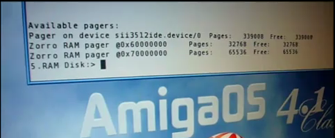

Here is a screenshot of mine showing two zorRAM's, one 128MB and one 256MB. The kernel should automatically detect them and list them with the memstat command.
Darren

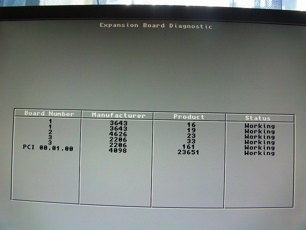

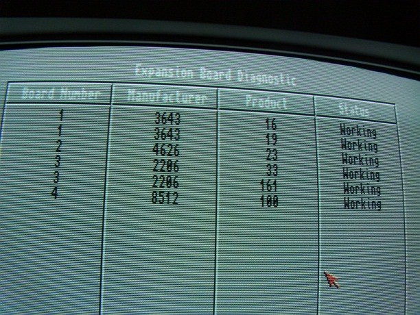

I hope that I have understood you correctly, I've done times two photographs, one on my Amiga monitor, the other on a TFT monitor!
Do I need to maybe change that kick in the layout, I've installed the ZorRam only and does not change any settings!
The ZorRam is definitely in order, we had tested over the weekend in another Amiga 4000!
I am at my end Amiga know, I'm probably too stupid for Amiga OS 4.1 Classic.
Yours sincerely,
Mika (Germany)
MIka, is there any way you can get me debug output? If you set the debug output to level 5 I should be able to see what is happening.
edit your startup-sequence and change the bootloader line to:
c:bootloader COMMANDLINE="debuglevel=5".
cold boot
after booting go to a shell and type:
dumpdebugbuffer >ram:debug.txt
cold boot
AmigaOS 4.x Beta Tester - Classic Amiga enthusiast - http://www.hd-zone.com is my Amiga Blog, check it out!
- DarrenHD
- Beta Tester
- Posts: 635
- Joined: Mon Dec 20, 2010 3:38 pm
- Location: London, Ontario, Canada
- Contact:
Hi again, can you list again for me all the cards you have in your computer?Mika wrote:Problems with 256 MB ZorRam
When I close the swap jumpers start my computer, my Amiga monitor displays only a yellow screen!
Mika
Mediator with: Radeon and what else?
Deneb?
ZorRAM?
Can you also open up the Ranger utility and tell me what memory ranges the Radeon card is using? A screenshot would be nice.
I have ALL the jumpers closed on my Mediator, including SWAP config and WinSize...
Darren
