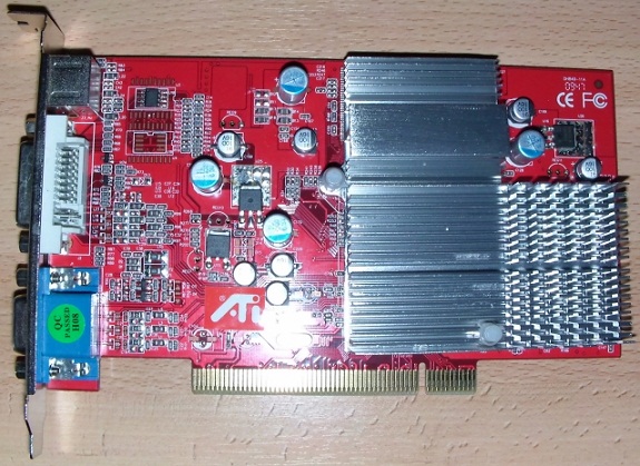

I wanted to report only in my Amiga the 4000D since yesterday a privately converted Radeon 9200 functioned!

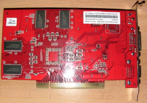

Oh,
A friend has converted the voltage on the graphics card.
I've installed the OS 4.1 Classic with my Voodoo 3000 graphics card.
I've changed my Kickstart4000 following:
; MODULE Kickstart/x86emu.resource.kmod
; MODULE kickstart / PCI / Graphics.card
New entries:
MODULE Libs: pci.library
MODULE Libs: Picasso96/Radeon
Additional entry in:
BOARD TYPE = file = Kickstart/p96Config Radeon
Radeon Storage monitors, moved to the Devs Monitors
Files of Elbox:
10.0 pci.library copied to Libs
Radeon.card 2.7 changes to Libs: Picasso96 copied
Then the Picasso96Settings of 3.9 (4.0), copy it into the drawer Devs
Then I closed the jumper on my board mediators, WinSize and really master will also be closed SwapConfig the jumper that goes with me, unfortunately not (yellow screen), so I have this left open.
I hope I made ​​myself understood, I got myself these tips from other users!
Yours sincerely,
Mika
AmigaOne G4, 1,266 Ghz und Amiga 4000D mit OS 4.1 Classic

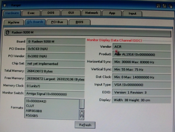

Yes !!!!!!!!!!!!!!!!!!!!!!!!!!!!!!!!!!!!!!!!!!!!!!!!! !!!!!!!!!!!!!!!!!!!!!!!!!!!!!!!!!!!!!!!!!!!!!!!!
My Radeon which works without limitations, native with the settings which are set by the OS 4.1 Classic, it was the wrong jumper settings on my mediator-board!
