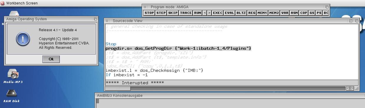

Re: Amiblitz 3.5 Debugger doesn't work since Update 5
I did use Amiblitz 3.5 sucessfully on AOS 4.1 upd. 4 on my SAM, just make sure to put reddebugger onto the JIT Blacklist (prefs)
- Attachments
- (67.38 KiB) Downloaded 3497 times
