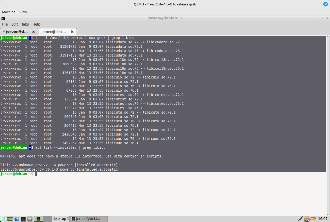

@xeno74 Did installing libicu72 solve the ArcticFox problem? If that is the case I will build a new ArcticFox package with a fix.
sudo apt install libicu72

mintppc wrote: Fri May 23, 2025 2:01 am @xeno74 Did installing libicu72 solve the ArcticFox problem?
Unfortunately not. :-(

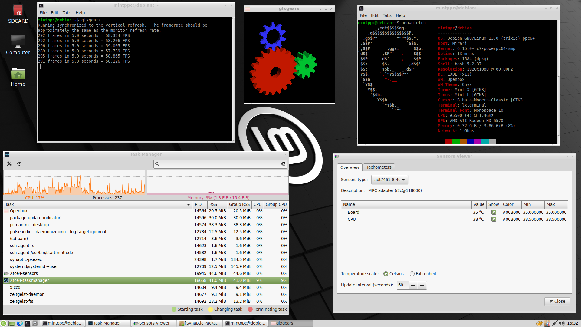

Strange, I have it working in MintPPC32.
