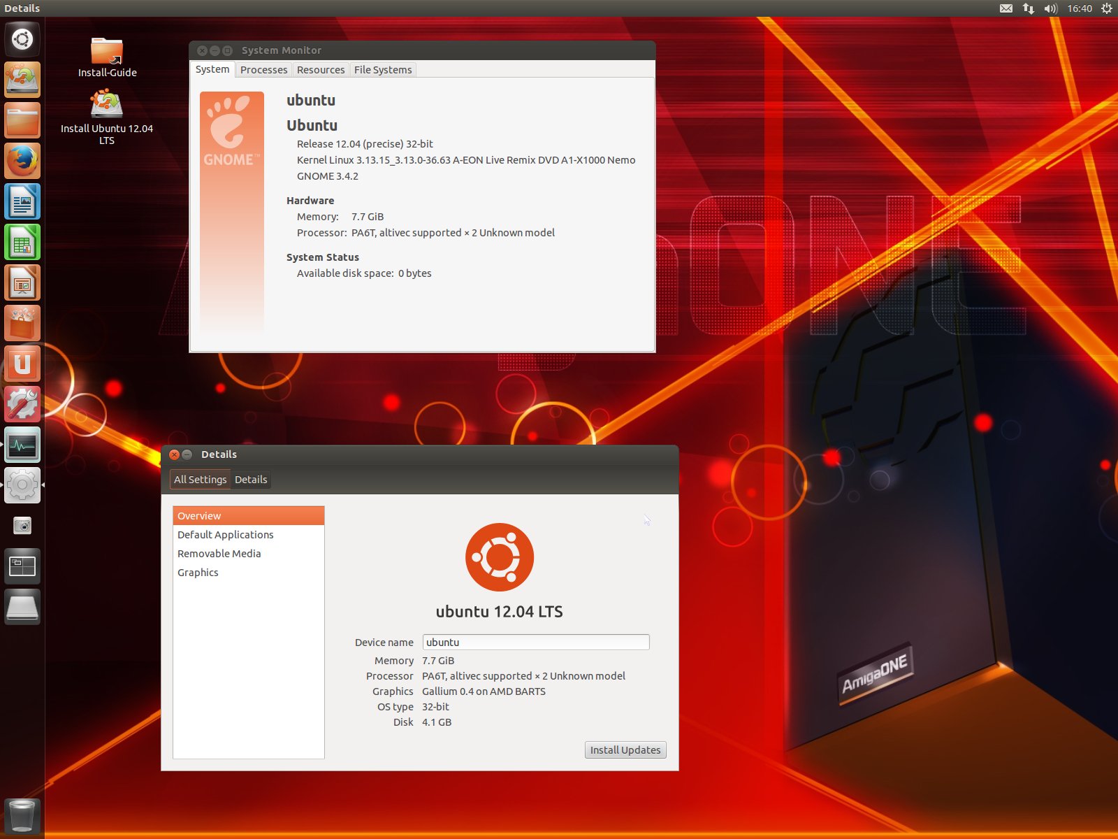

I released a new version of the Ubuntu longterm kernel for our A-EON Live Remix DVD.
Download: kernel-3.13.15-1-x1000-ubuntu-ppc64.tar.bz2
It based on the kernel version 3.13.0-36.63 by the Canonical Kernel Team.

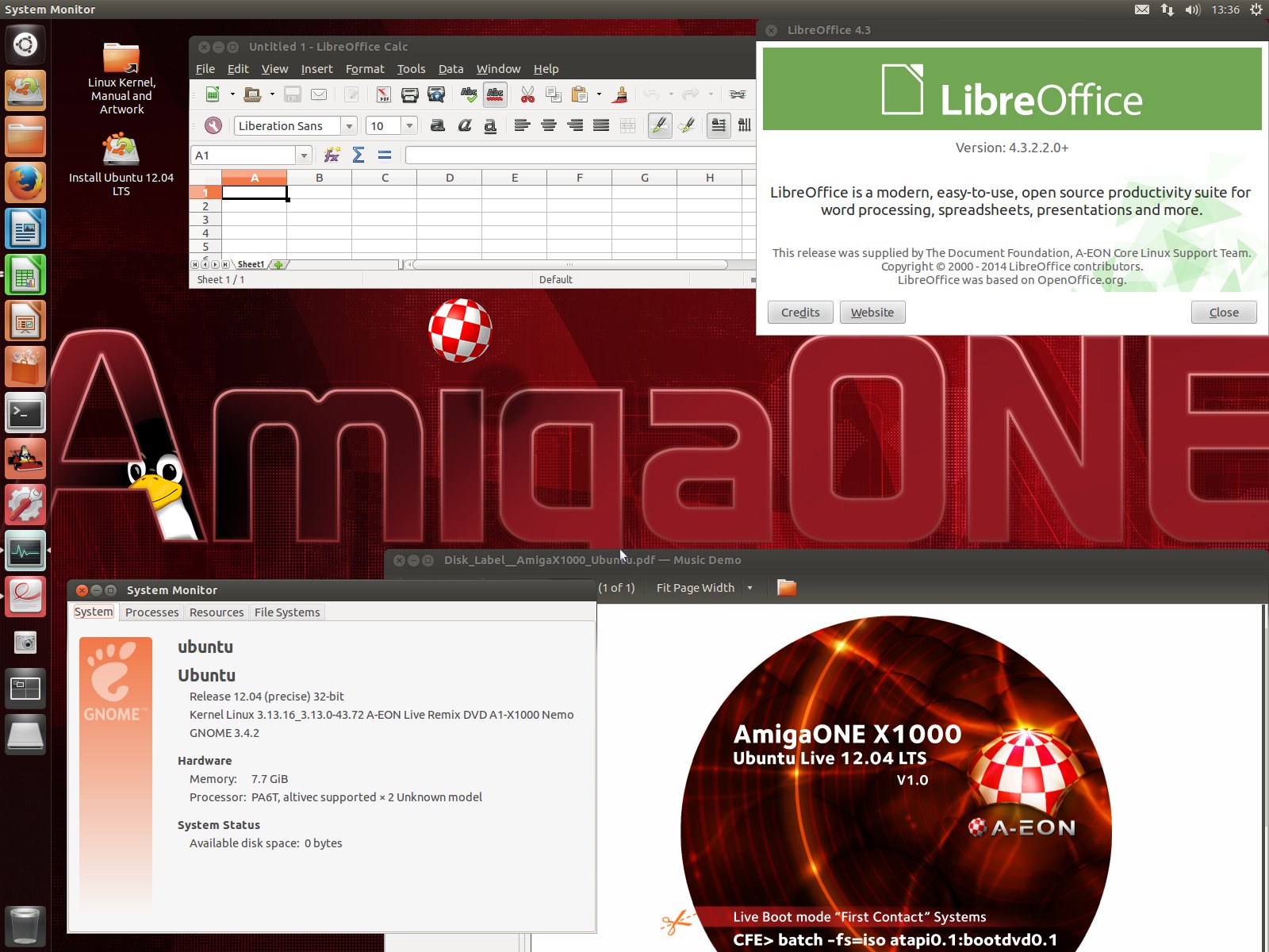

A new Ubuntu longterm kernel is available for our A-EON Live Remix DVD. It based on the kernel version 3.13.0-43.72 by the Canonical Kernel Team.
Download: kernel-3.13.16-1-x1000-ubuntu-ppc64.tar.bz2
New: www.ubuntuupdates.org

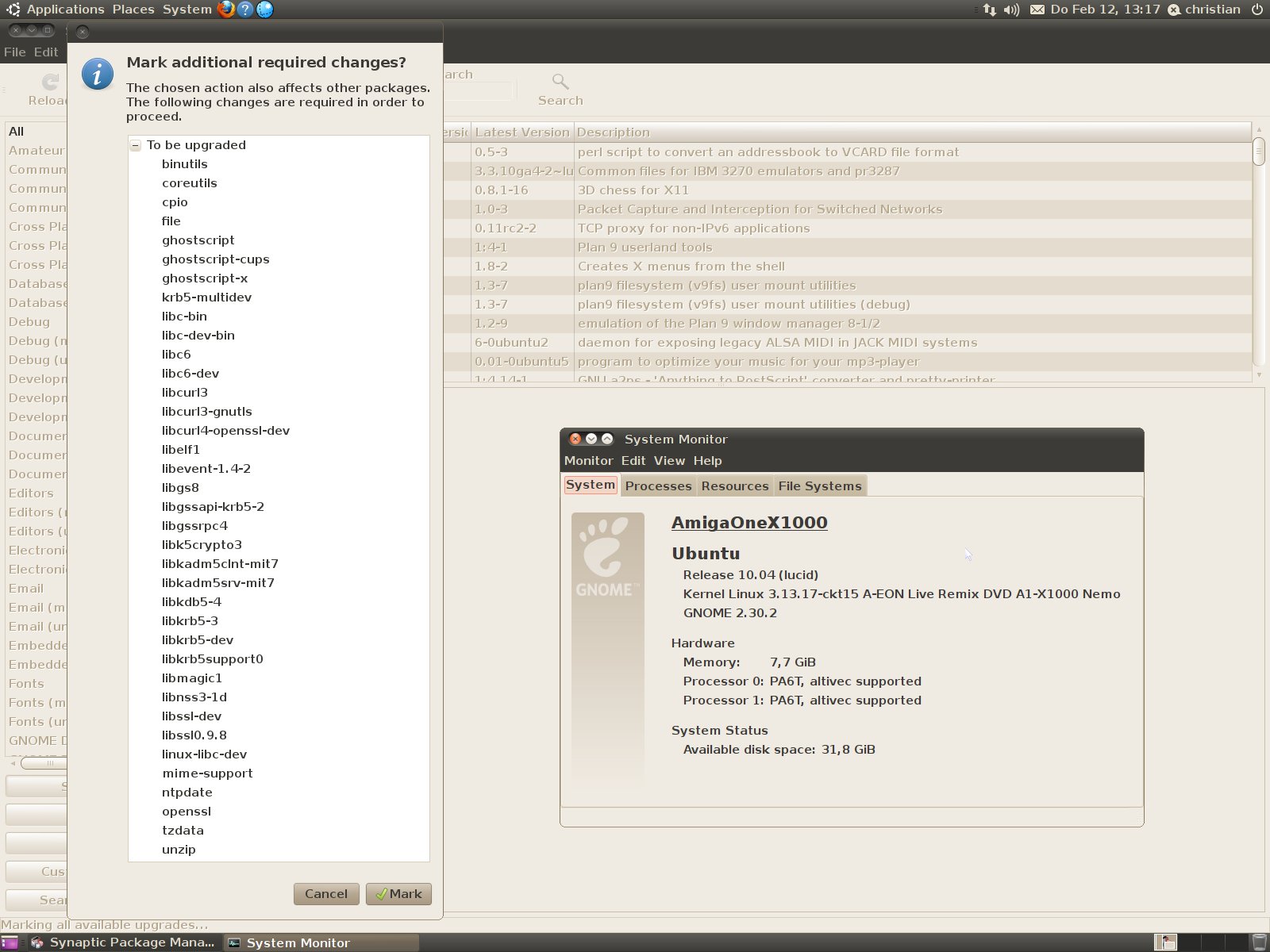

I had compiled the Ubuntu LTS kernel 3.13.17 (3.13.0-46.75/ckt15) and then I tested it with Ubuntu 10.04.4 LTS. It works without any problems with this old Ubuntu. And I have gotten some updates for this old Ubuntu today.
