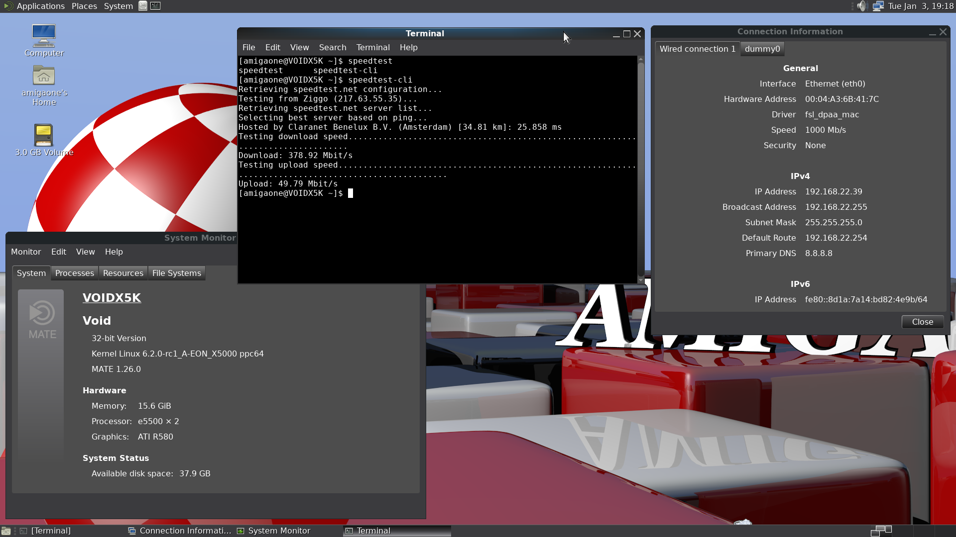

Posts: 972
Seans patched RC1 DPAA-T1 kernel is up and running with working DPAA Ethernet.
Big picture: https://www.skateman.nl/wp-content/uplo ... -18-07.png

Posts: 11172
Skateman wrote: Tue Jan 03, 2023 8:25 pm Seans patched RC1 DPAA-T1 kernel is up and running with working DPAA Ethernet.
Fantastic! Thanks for testing!
