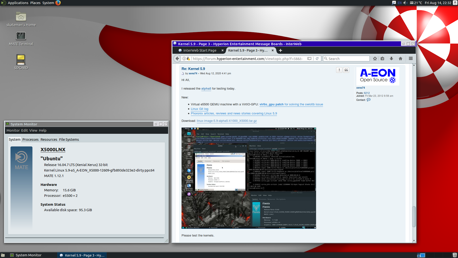

Re: ubuntu MATE 16.04.1 LTS Live USB
Some download links are dead in this thread. I updated Julian's ubuntu MATE 16.04 USB Live img version 3 with new kernels and dtb files and uploaded it today. The alternate installer script is included in this img.
Download: X5000_Ubuntu_16.04.1_Live_USB-3c.img (md5sum: ee187684c6ea426a1558aef55b44232d)
I would recommend you to use Fienix instead of ubuntu MATE 16.04 because it is based on the latest Debian Sid and it is really faster and better supported.
U-Boot commands for booting the ubuntu MATE 16.04 Live USB system:
  1. Code: Select all
    usb reset
  2. Code: Select all
    setenv bootargs root=/dev/ramdisk file=/cdrom/preseed/ubuntu-mate.seed boot=casper rootdelay=5
  3. Code: Select all
    fatload usb 0:1 1000000 uImage-5.8 or uImage-5.7
  4. Code: Select all
    fatload usb 0:1 1c00000 cyrus-p5020.dtb or cyrus-p5040.dtb
  5. Code: Select all
    fatload usb 0:1 2000000 uRamdisk
  6. Code: Select all
    bootm 1000000 2000000 1c00000
For Radeon Southern Island cards you have to edit the xorg.conf. Please change the line Driver "radeon" to Driver "fbdev".
You can also install ubuntu MATE 16.04 with the base installer img.
Download: Amigaone_Ubuntu_16.04-Base-1.img.7z
Installation instructions: ubuntu MATE 16.04.1 LTS Live USB
Note: Some USB sticks aren't suitable for booting Linux kernels and initial ramdisks from a FAT partition. U-Boot doesn't find any storage devices on the problematic sticks.
PLEASE try another USB stick if you have problems with booting from a FAT partition.
Please test the images.
