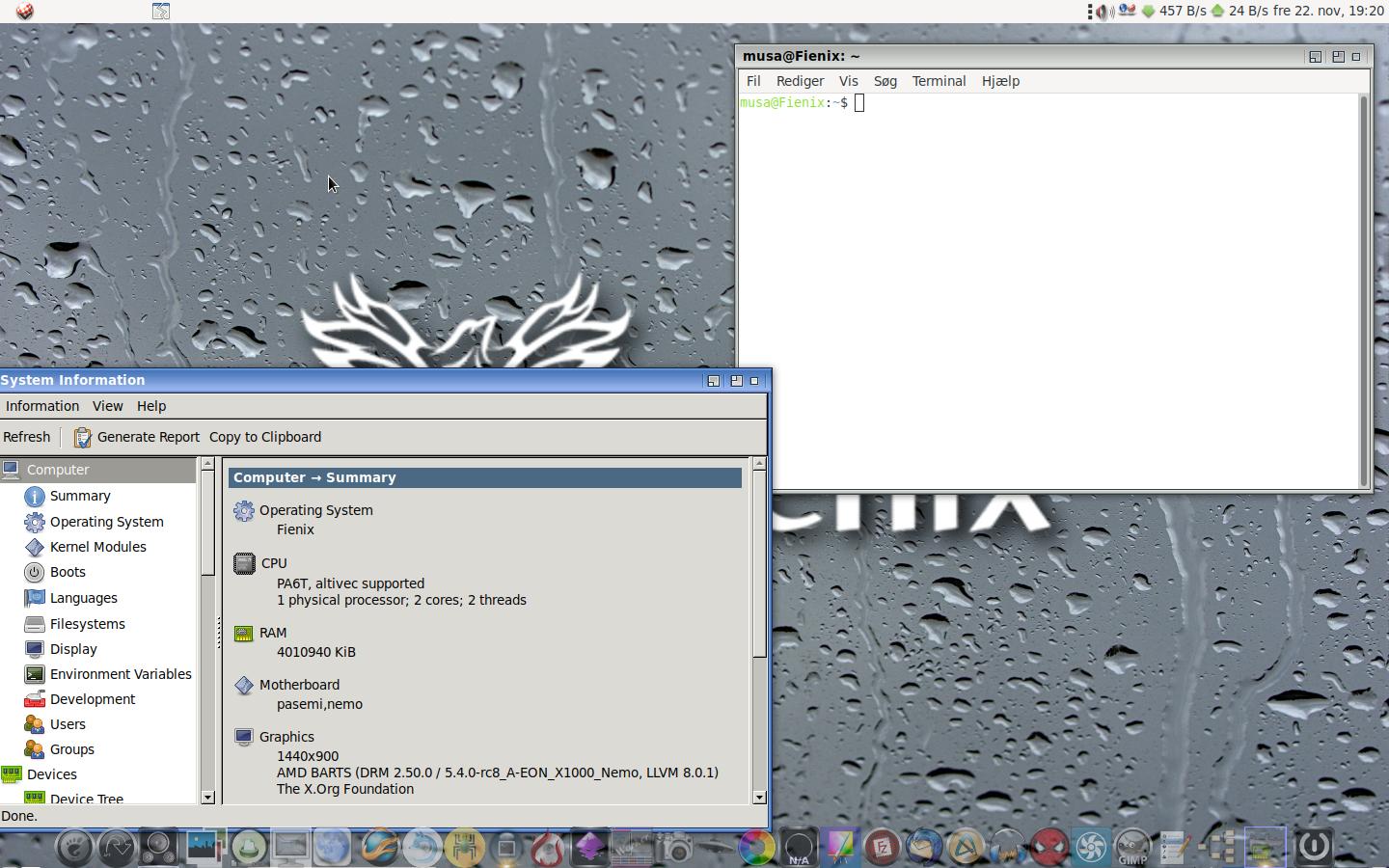

Hi Christian
I copied vmlinux-5.4 onto a usb drive and then tried the kernel from there. As you can see in the picture, Fienix starts without problems.
Also tested the zimage-5.4 and it booted too. Mate terminal also opens.
So I have a problem with my cf card :( . The weird thing is that all old kernels work.

Good to know. Many thanks for testing the RC8! Did you copy the kernels with OS4.1 to the CF card?
Re: Kernel 5.4
I have now halved the size of the cf card and formatted in fat 16. Now all errors away.
No I haven't used Os4.1 but used ubuntu 17 remix.

Good idea with the half size and FAT16! Thanks a lot for the info!
