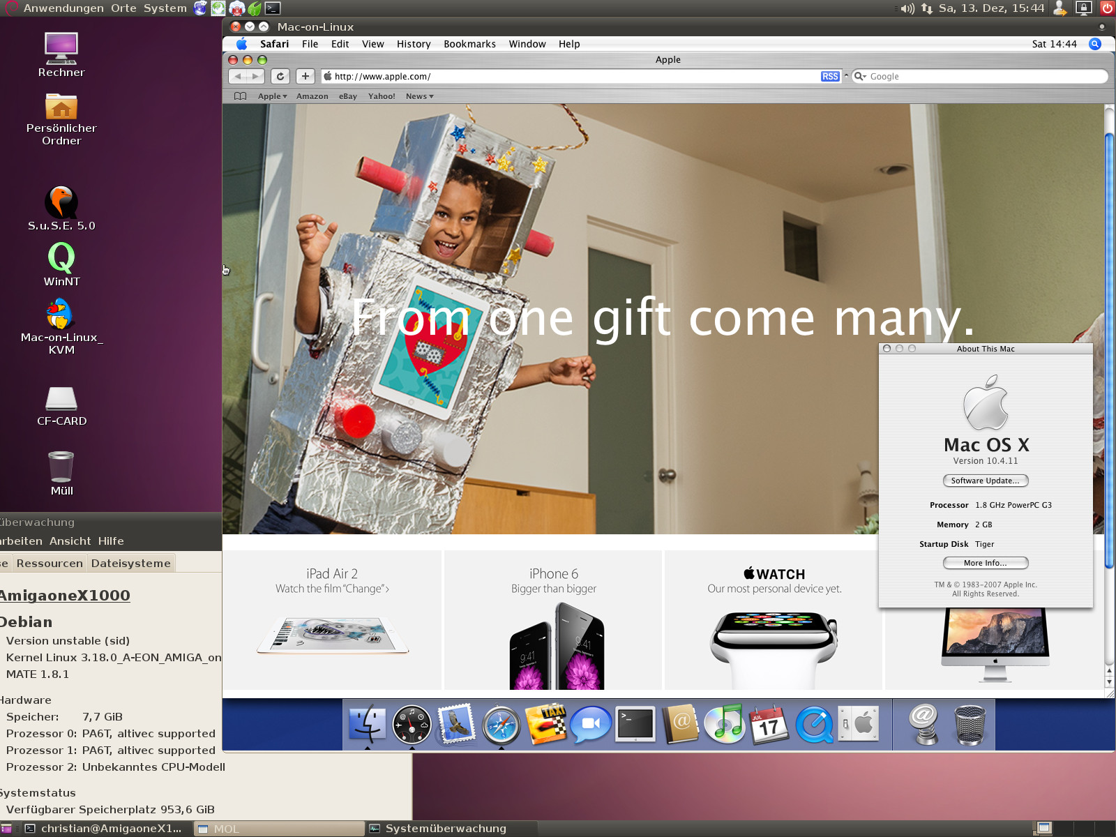

I compiled the kernel 3.18 final nativ on my AMIGA one X1000 this morning.
  • Support for the EHCI implementation that's originally from ARC. These EHCI chips have vendor-specific extensions to integrate transaction translators, so that no OHCI or UHCI companion controller is needed.
  • Support for mobile networks with USB UMTS 3G sticks
  • KVM_BOOK3S_64_PR
    Support running guest kernels in virtual machines on processors without using hypervisor mode in the host, by running the guest in user mode (problem state) and emulating all privileged instructions and registers.
    This is not as fast as using hypervisor mode, but works on machines where hypervisor mode is not available or not usable, and can emulate processors that are different from the host processor, including emulating 32-bit processors on a 64-bit host.
  • Mac-on-Linux support
  • Network support for AROS hosted
  • Support for 4 serial ports
  • Bluetooth USB dongle support
  • Kernel tracing with ftrace
Other changes: http://lkml.iu.edu/hypermail/linux/kern ... 05308.html
Download: vmlinux-3.18.0-KVM-PR-OVERLAYFS-AMIGA_one_X1000.tar.bz2
Thanks to everyone for testing many release candidates.
Enjoy the new kernel.
