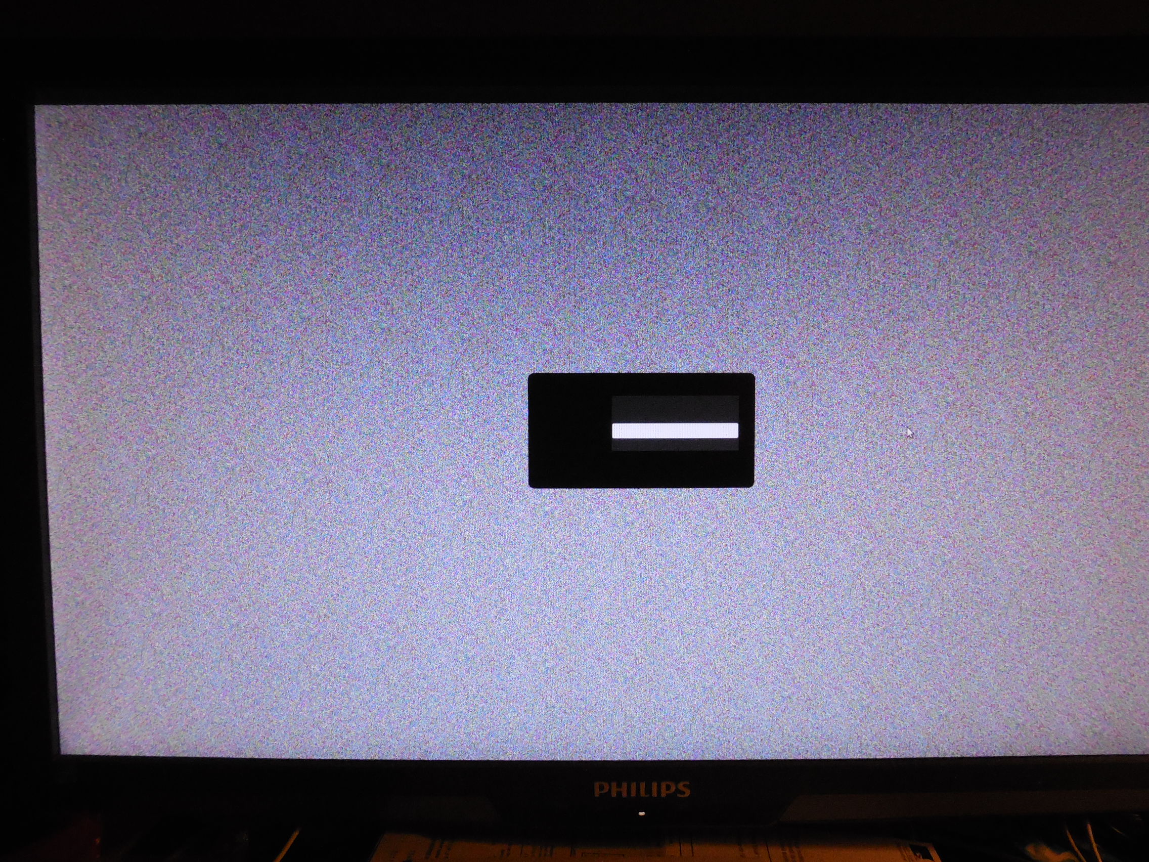

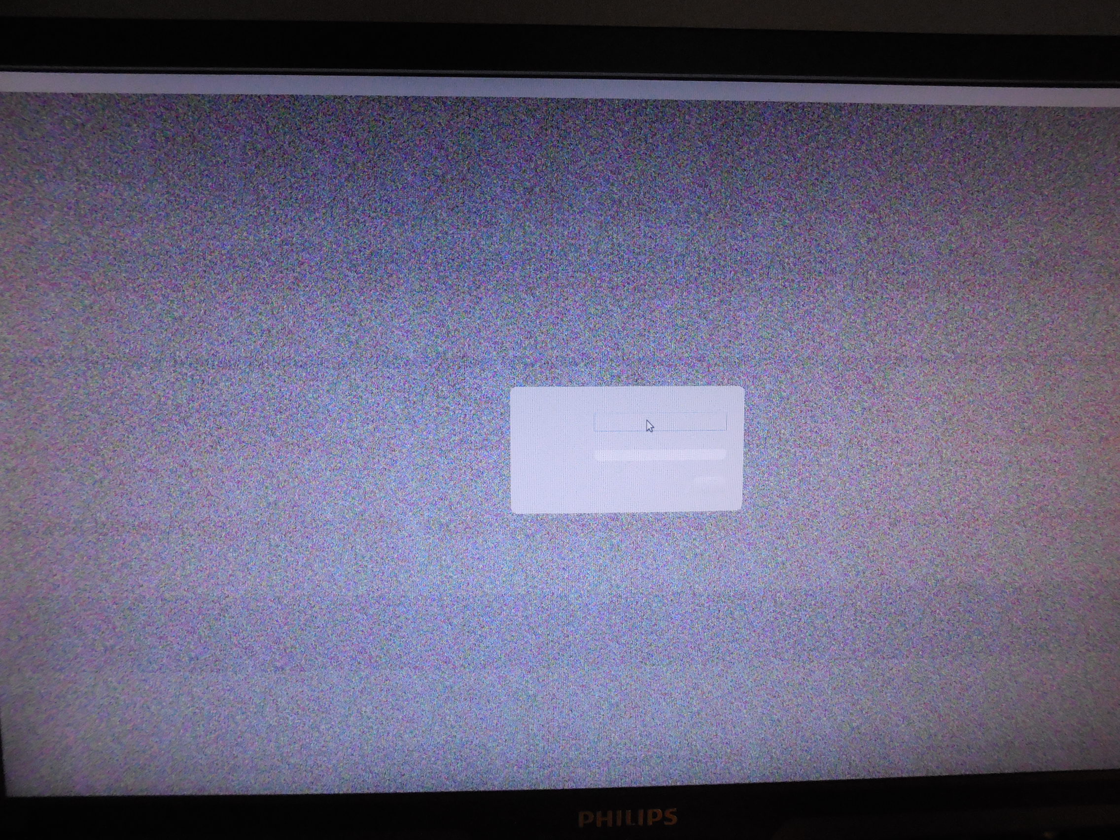

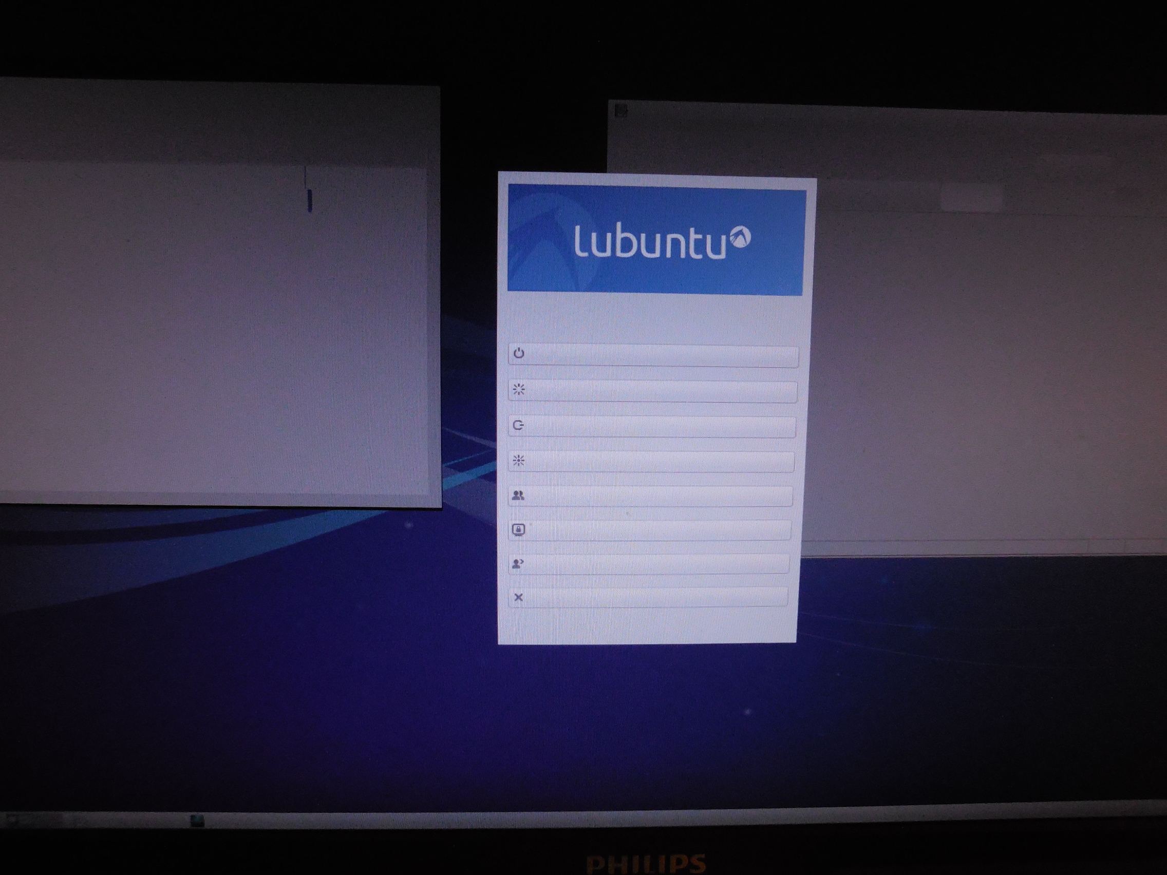

Re: Problem installing Lubuntu 14.10
Post by zzd10h »
Installation completed, I just selected Lubuntu Desktop during package selection.
At reboot (tested 2 times), the gfx is trashed and no text is displayed.
Is somebody encountered that ?
Thank you
HD6670 and kernel 3.19.
Post by zzd10h »
New install by selecting only "XUbuntu" and "Extra fonts" packages.
Same results :
Posts: 11172
zzd10h wrote:Installation completed, I just selected Lubuntu Desktop during package selection.
Thank you
I had the same problem that the fonts were not displayed. The solution is to set the option "RenderAccel" to "false" in the xorg.conf file.
Option     "RenderAccel"	"false"
