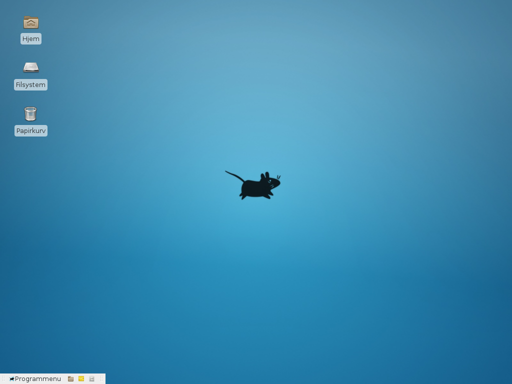

Ok
I tested Gnome and gnome-Openbox : will not start.
I tested mate and it works but freeze sometimes

I have tested xfce and it works

I'm having problems with Firefox that will not start from icon but but sometimes, from a terminal
The attachment Skærmbillede2.png is no longer available
When the system starts and about where X should start nothing happens but after 2 min Suse background is coming but no login. Then there will be black screen and after 4 min comes Suse background again, this time with login
