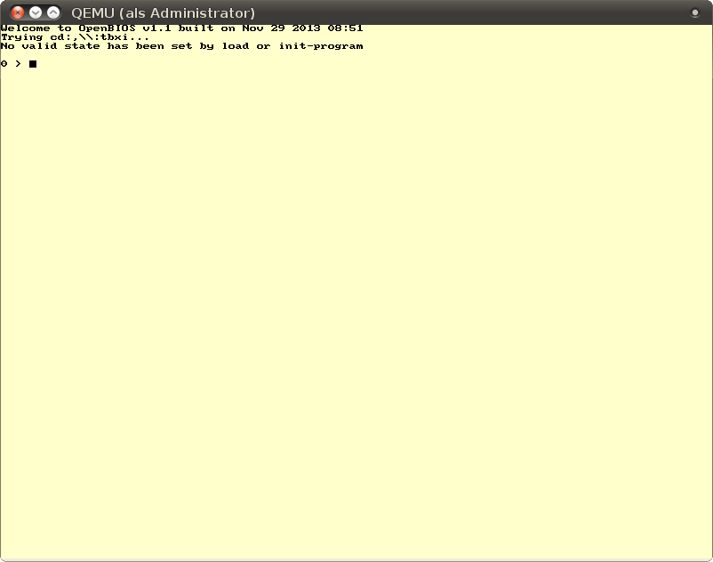

Unfortunately, Yaboot doesn't boot. You have to boot it with the following command:
boot cd:,\suseboot\yaboot

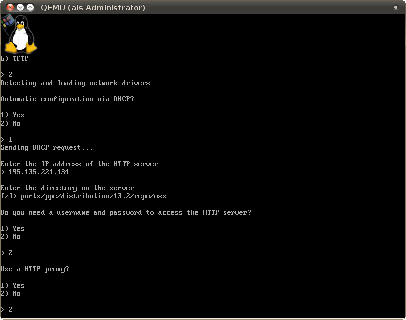

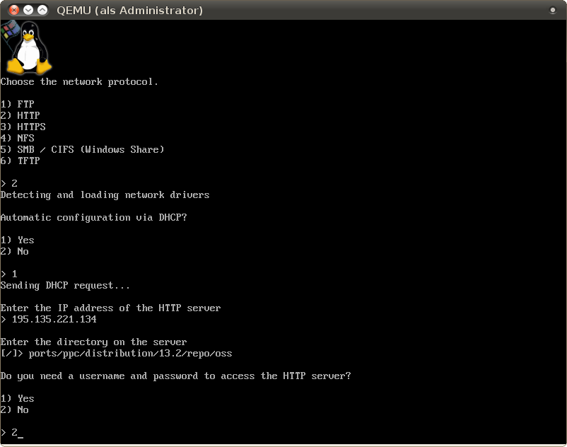

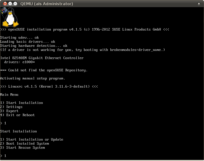

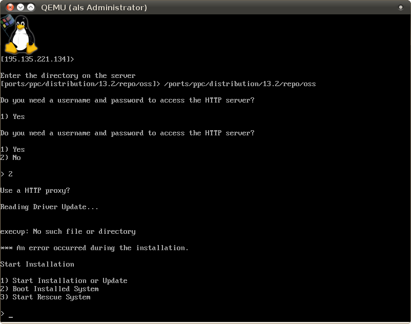

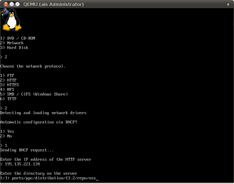

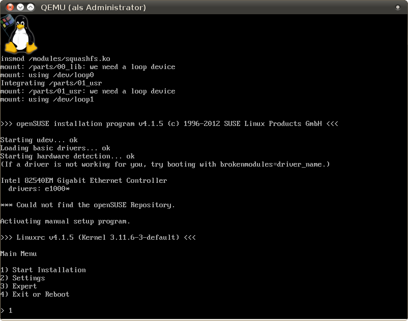

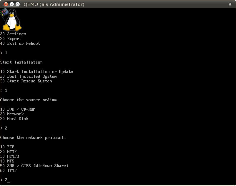

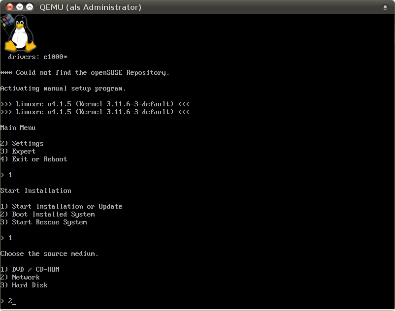

The setup program doesn't find the repository.
I try it with the following address:
/ports/ppc/distribution/13.2/repo/oss
But It doesn't work either. There is a repository available but it doesn't work with the 13.1 NET ISO.

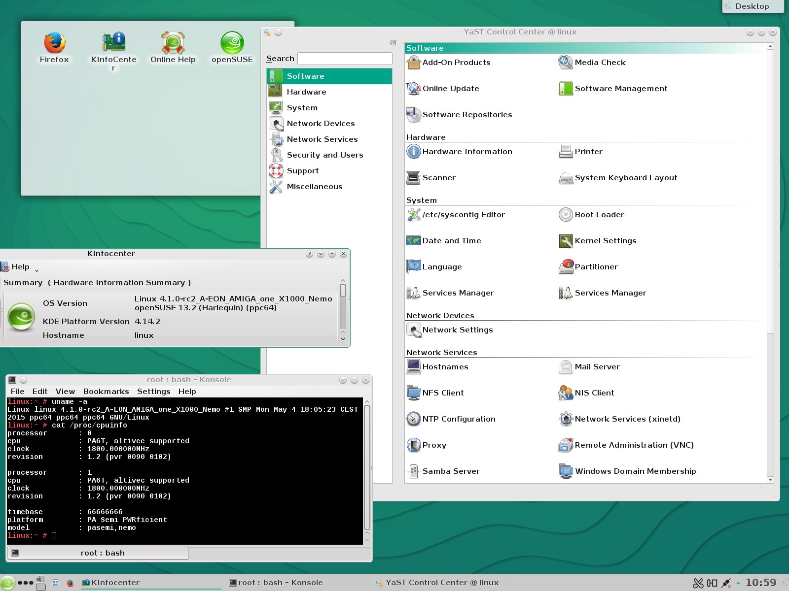

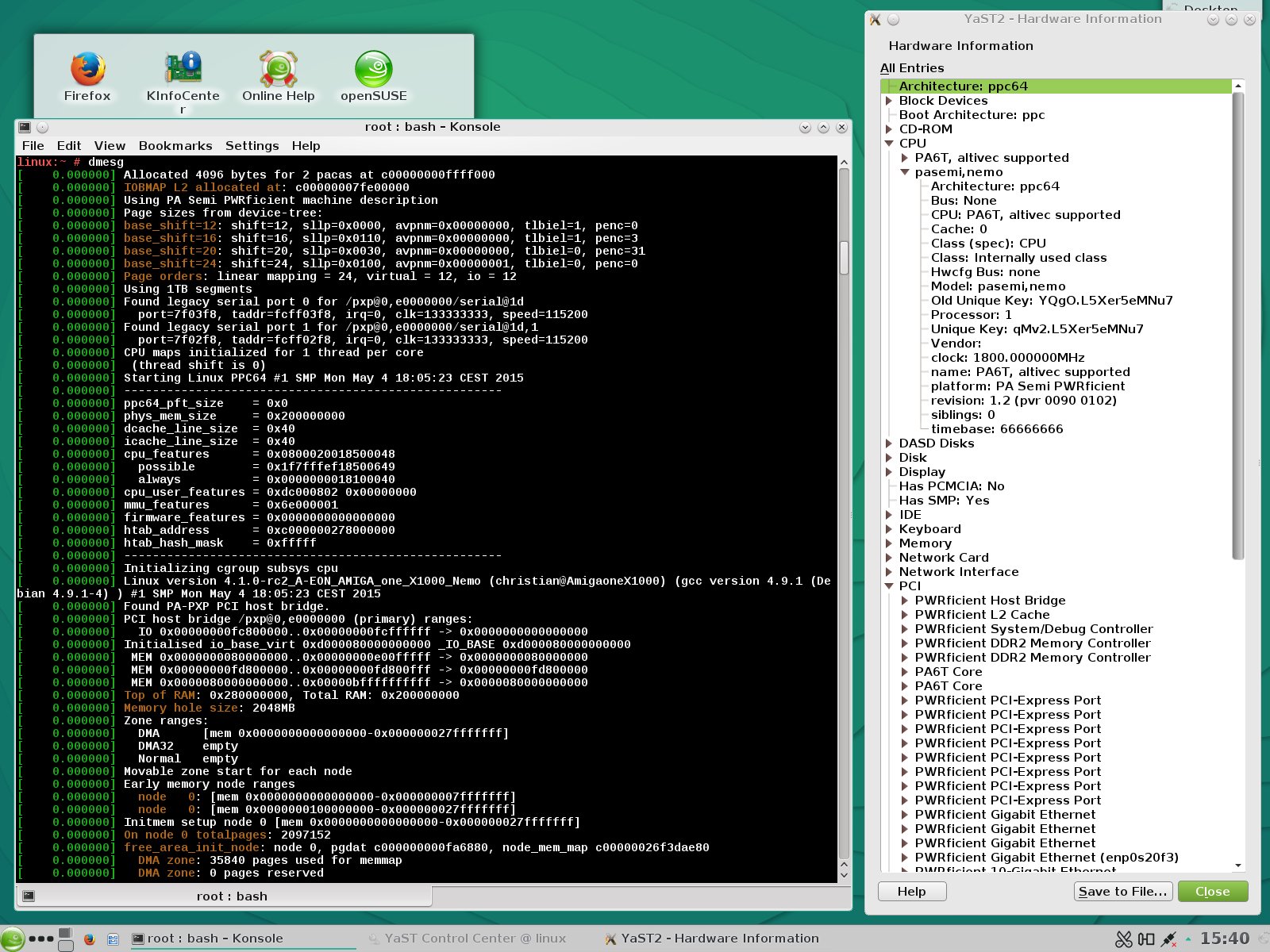

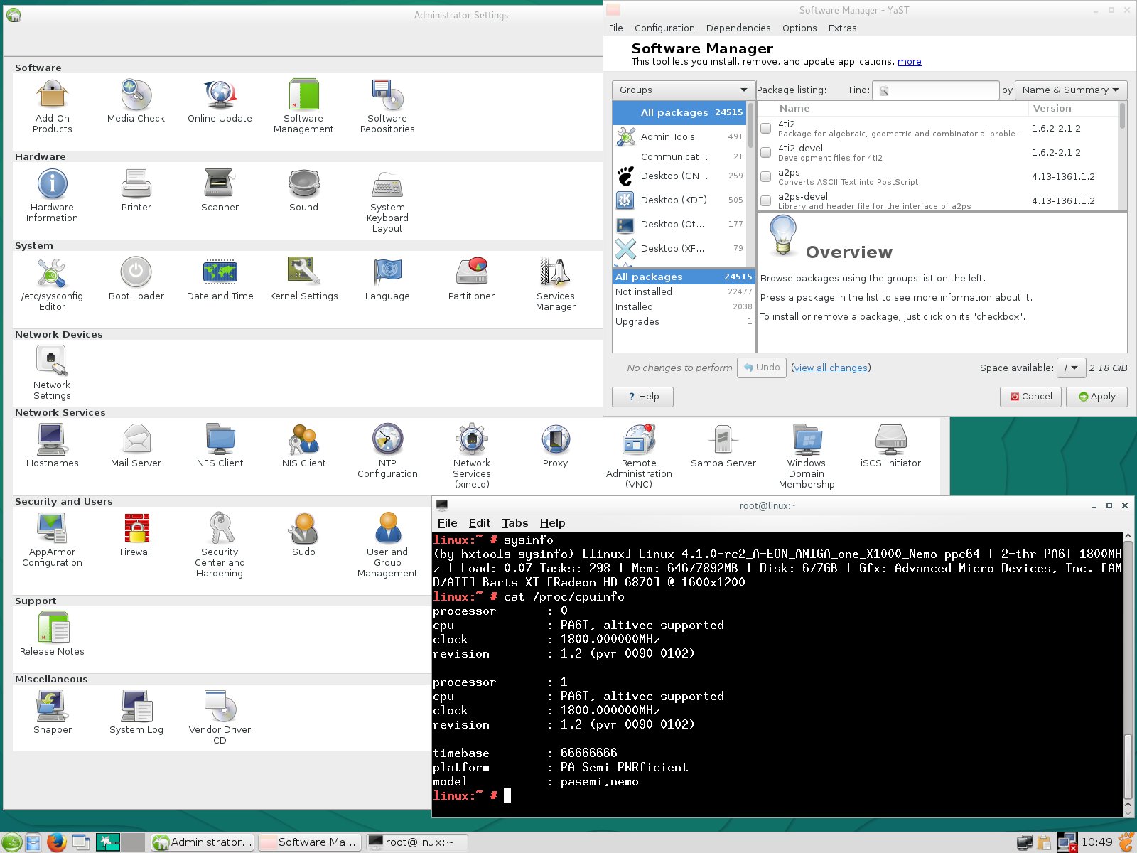

Another screenshot:
Posts: 11250
Re: openSUSE 13.2
LXDE on openSUSE 13.2 PPC64:
