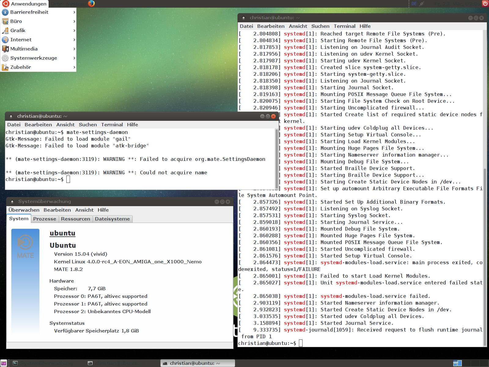

With systemd you don't need the rw boot argument but unfortunately the mate-settings-daemon doesn't work (see screenshot).
I had to reinstall Upstart.
sudo apt-get install upstart
After that, the mate-settings-daemon works without any problems.
Posts: 11265
Re: (X)(L)ubuntu (MATE) 15.04
I installed the packages libatk-adaptor and libgail-common because of the error messages in the screenshot above. The error messages are gone but unfortunately it doesn't solve the problem with the mate-settings-daemon.
sudo apt-get install systemd-sysv libatk-adaptor libgail-common

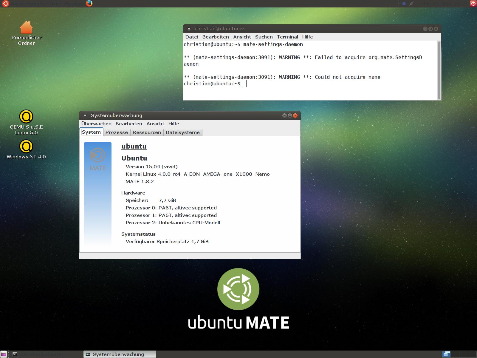

That's incredible. The mate-settings-daemon starts 10 minutes later after the desktop login. It means it works but I have to wait 10 minutes after the login.
Posts: 11265
Just for info: Since the last update I can't activate Upstart. I have to use systemd. With systemd, the mate-settings-daemon starts 10 minutes later after the desktop login. It means it works but I have to wait 10 minutes after the login.
Posts: 11265
xeno74 wrote:Just for info: Since the last update I can't activate Upstart. I have to use systemd. With systemd, the mate-settings-daemon starts 10 minutes later after the desktop login. It means it works but I have to wait 10 minutes after the login.
I found a way to reactivate Upstart. :-) You can reactivate Upstart with sudo apt-get install upstart-sysv. After that the mate-settings-daemon works without any problems.
