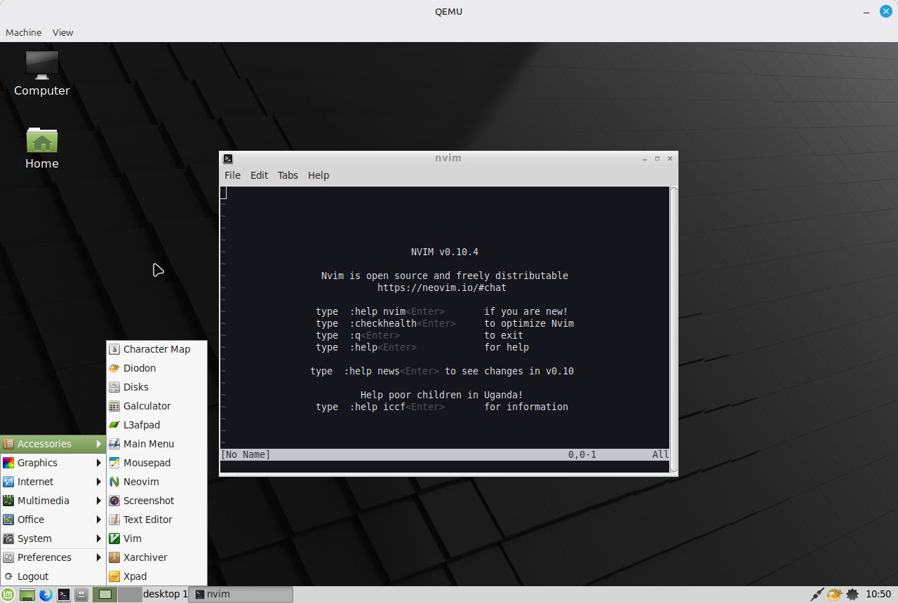

I built NeoVIM but as expected, some python tests failed because I had to built some python build-deps with tests disabled, otherwise they would not build (tests failed there because of segmentation faults). So I have a build, but it could be buggy, don't know. You would have to test it to see for yourself. I attached the failed tests.
To install:
apt install neovim
to start, in the console
nvim
I don't see it in the menu, don't know why. I added it by installing alacarte, it then saw neovim.
