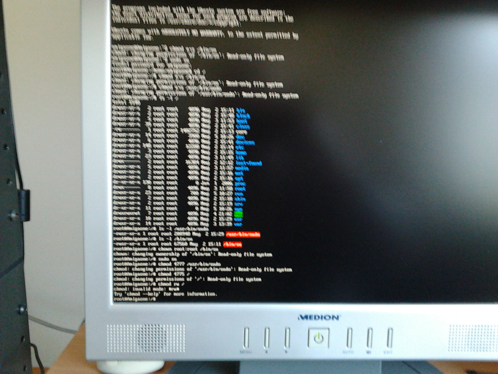

Hi Christian,
first I have started ubuntu 12.04 and done the above commands on sdb8....
Then I started Mate_1604 from sdb8.
When I did "ls -l /usr/bin/su " the result now looks with the s bit set. (see picture ).
But still the "chown root:root /bin/su" tells me that I have a read-only filesystem.

papaoskar wrote: Hi Christian,
Hi Papaoskar,
Thank you for your answer. With the following boot arguments, the kernel mounts the root file system with read and write support.
setenv bootargs "root=/dev/sdb8 rw"
Please try it.
Thanks in advance,

Hi Christian,
the new bootargs argument did the trick! Currently the update and upgrade commands are at work. It takes its time. I tried the rw argument before but to no avail. Probably because I did not switch off long enough. Thanks so far.
