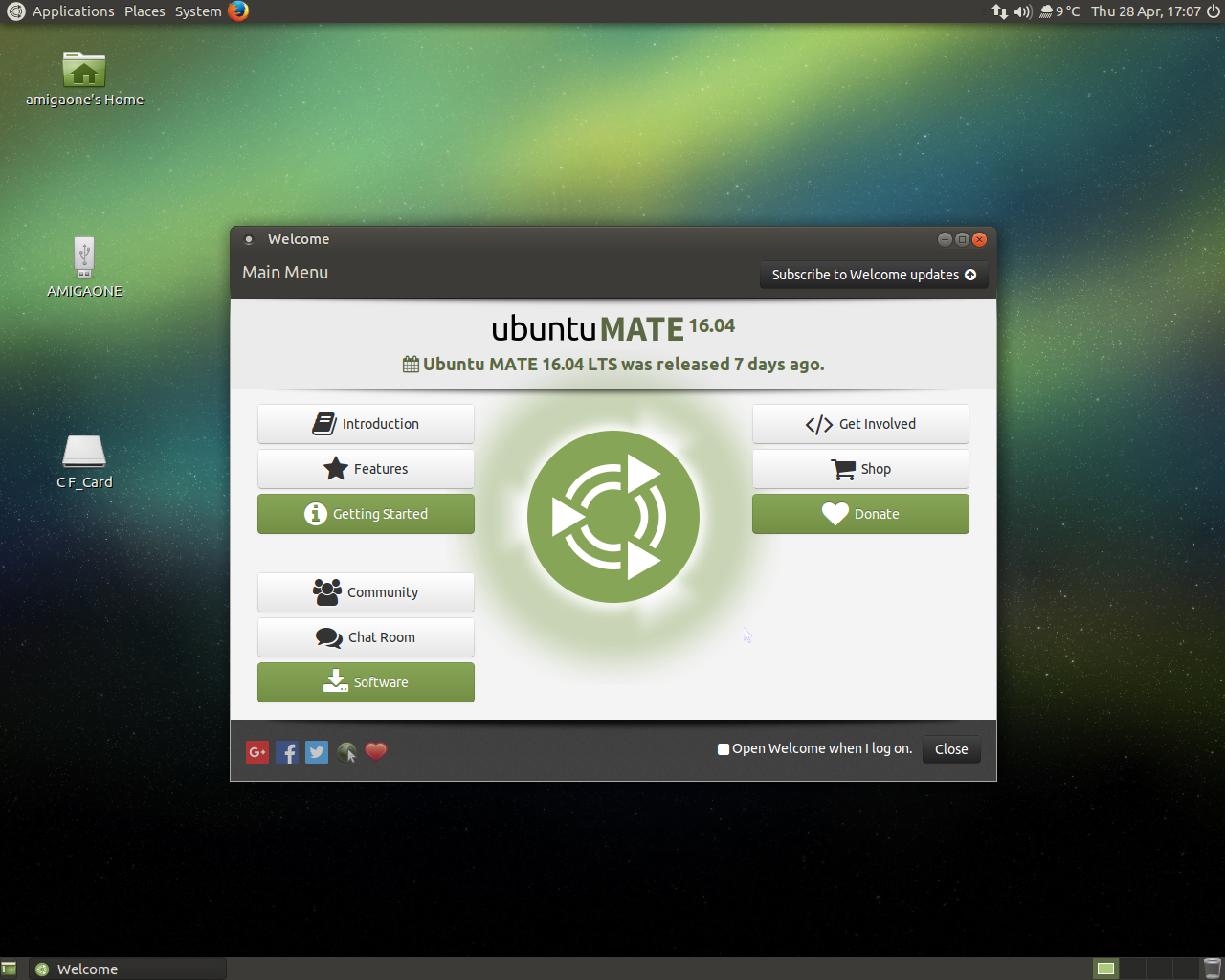

I copied the stick content to a /dev/sdb8 partition , it boots, but no graphical screen. I am writing this on the new system Mate 16.04!
As a proof I attach a screen picture of my desktop. Any suggestion what to do now [question mark*]

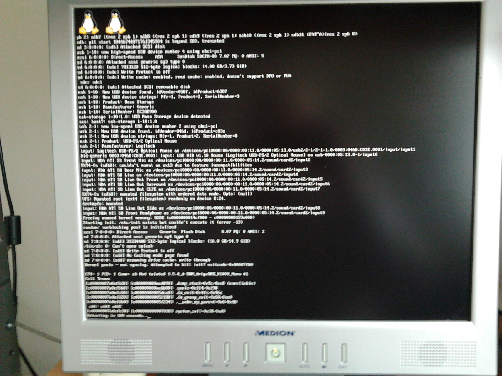

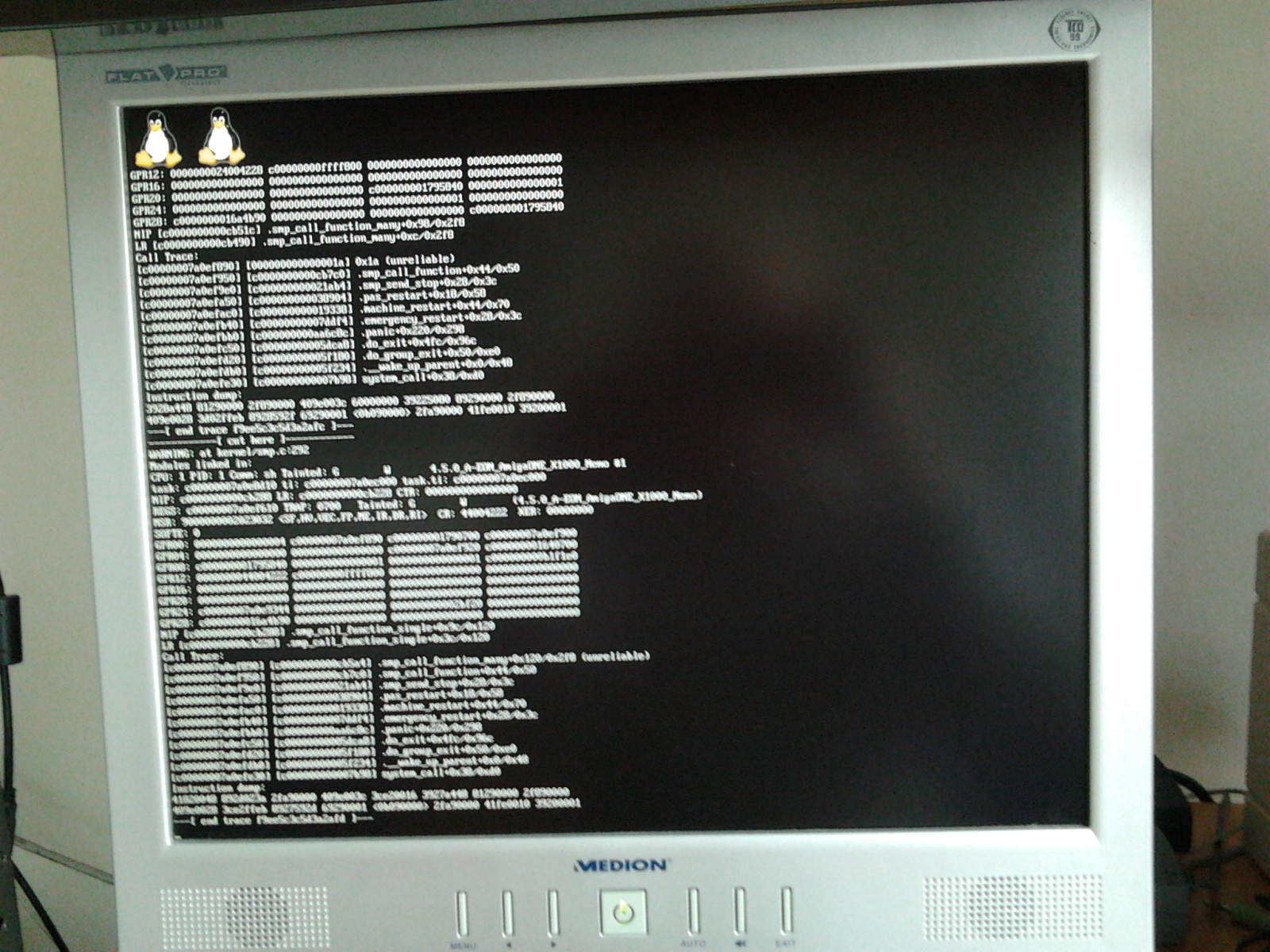

Hi Christian,
the booting process was not successful. I made two pictures with my mobile phone, excuse the bad quality. But I think they are still readable. Please, find them attached. From my understanding, the init could not be started. Why?
Posts: 11172
papaoskar wrote:BTW, there are a lot of errors reading 'proc/sys/net.... either input/output errors' or ' for reading Permission denied '.
Did you copy the content with root permissions (sudo su)? Please mount /dev/sdb8 and tell me the file owner and group and the file permissions of /sbin/init with ls -l. Additionally please look if the directory /etc/init exists.
