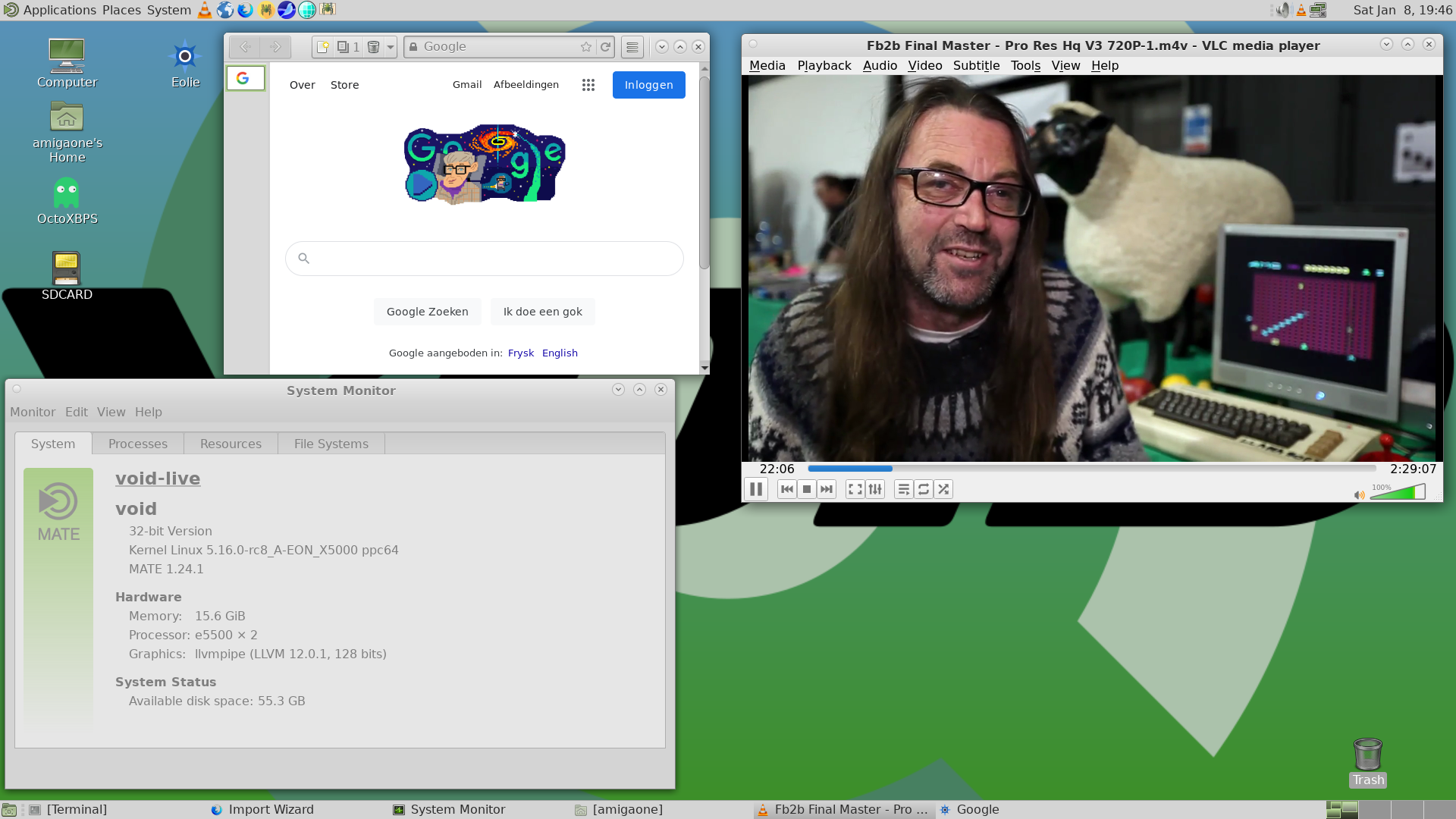

Kernel 5.16 RC8 up and running using Voidlinux (for the first time)
Big picture.. https://www.skateman.nl/wp-content/uplo ... -46-49.png
Still solving some issues with Voidlinux at the moment!..
UPDATE... after updating Voidlinux....its broken... :-) My screen is pixelated and unreadable... might need to fiddle with an Xorg.conf again..

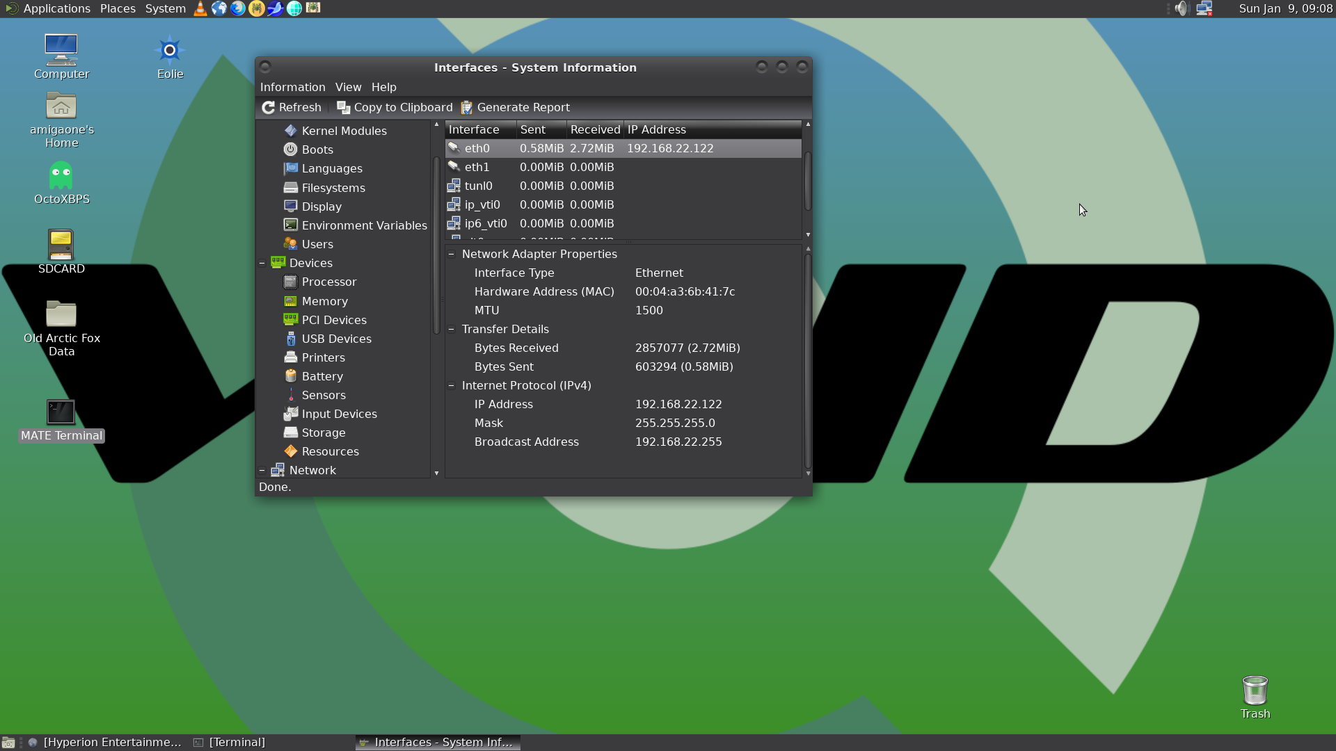

Re: Void Linux
Nope.. network manager is not running. But Onboard interace ETH0 is up and functional...
[amigaone@void-live ~]$ sudo dhcpcd
Password:
sending commands to dhcpcd process
Seems to do nothing...
As i DD`d the partition of the void-live image to my sdb1 partition...could this be a problem ? All seems to function well.
Big picture: https://www.skateman.nl/wp-content/uplo ... -08-46.png
