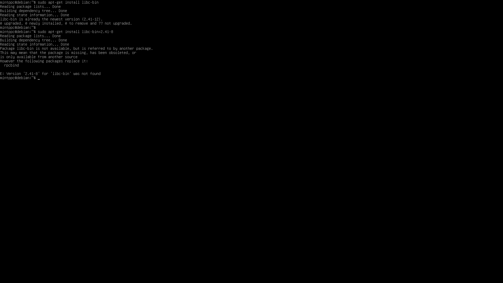

So, I did a fresh install and before bothering to get X working (I need to create a manual config) I figured I'd look at the upgrade again. I fixed the mesa issue, then just did a global apt update / upgrade and just hit the same problem again so it wasn't just some random issue. Which is actually sort of nice that it's not just me!
I'm pretty sure this is a problem with libc. Yes, systemd was also updated but the package everything seems to get stuck on seems to be libc.
I get a tonne of these messages during the upgrade - zoom the images below to be able to read them!:
Maybe it's naive of me to think that I can do this, but I have tried to downgrade libc-bin to the last version the log says was installed and it's like libc-bin doesn't exist. So that's probably my understanding of how the packaging works (again, zoom to read):
So at this point I'm a bit stuck. I have a lot of failed packages and seemingly no way to fix them. I need to go out this afternoon which means powering off the machine and will lose the ability to boot the install again.

You can’t just install an older libc, it will break everything.
I am not sure what you have to do. Maybe filing a bug report and wait for a fix before upgrading from a fresh installation?
