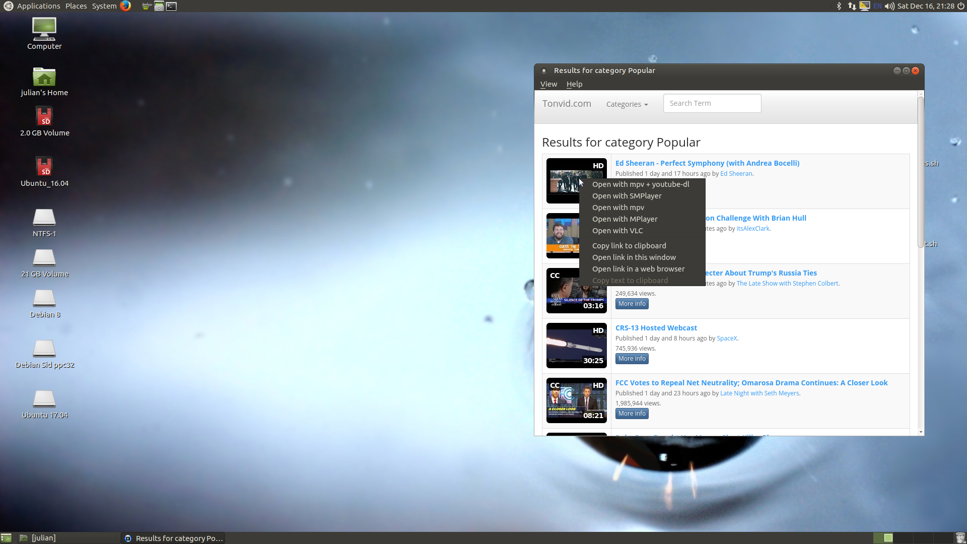

Youtube browser for SMtube selection with right mouse button.
Use open with mpv + youtube-dl .

Oh, yeah. YouTube browser still does nothing.

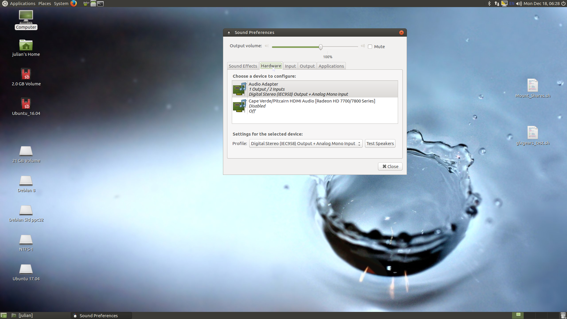

You need to have sound working to get any sound .
The options that work for me are either HDMI sound or a USB sound card.
For the HDMI sound you need to have a monitor that supports HDMI sound and is connected to your video card via a HDMI cable.
This is the model USB sound card that I use. Similar cards should also work .
https://www.startech.com/Cards-Adapters ... CUSBAUDIO7
You then have to Identify the sound card in sound prefs and set is as the default option .
You can disable any options you don’t use or don’t work in your configuration.

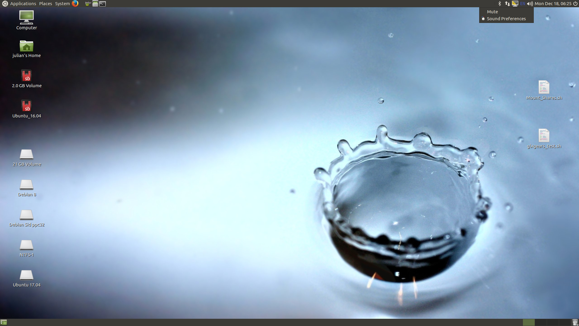

You can access the sound prefs via the Application menu : sound & Video : Sound
Or by right clicking on the Sound Icon on the upper right hand Menu Bar.

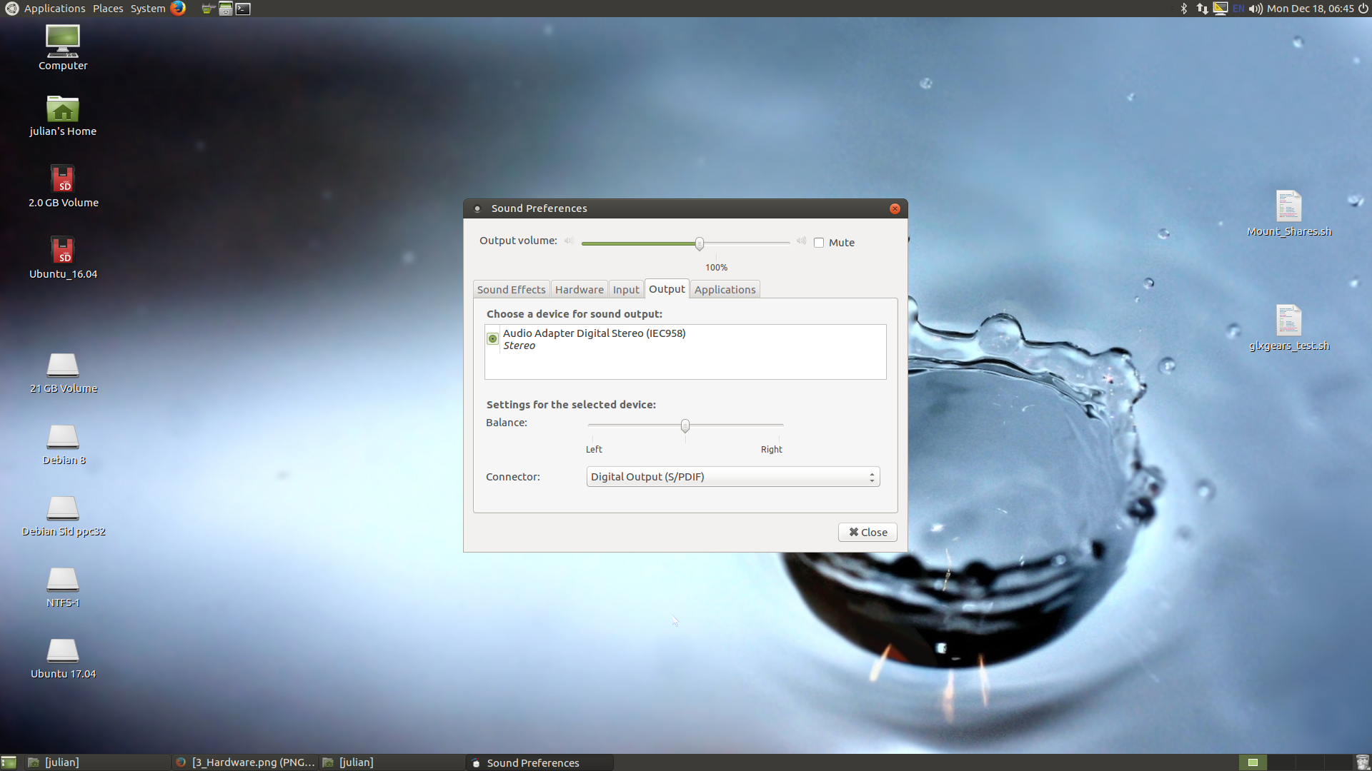

Set the device for output .

I ended up ordering a USB sound card, and it came two days ago. Meanwhile sound had started working, to my surprise. I could click on an MP3 file and get nice sound. I'm not sure if it would play the file all the way through -- I was just testing to see if it worked. But then there was a Youtube song I wanted to hear all of, and it worked fine for 37 seconds. Then it quit, and I haven't been able to play anything again since.
So I went ahead and tried the new USB card (Sound Preferences says it is "CM 108 Audio Controller 1 Output /2 Inputs Analog Stereo Output + Analog Mono Input ." The speaker test works just fine. (The speaker test seems to work fine with everything, whether it will play an audio file or not.) But when I try to play an MP3 some tiny window opens and closes so fast I can't make it out, but I have reason to believe it is VLC media player. I removed the USB thing and tried to set things up the way they had worked before, which came out on the Output page as "CMI8738/CMI8768 PCI Audio (CMI8738/C3DX PCI Audio Device) Analog Stereo, Connector: Analog Output," when it was sort of working -- I screenshot the window. But I haven't been able to get it back as it was. I went back to the USB card; with that the only Connector allowed is "Speakers."
