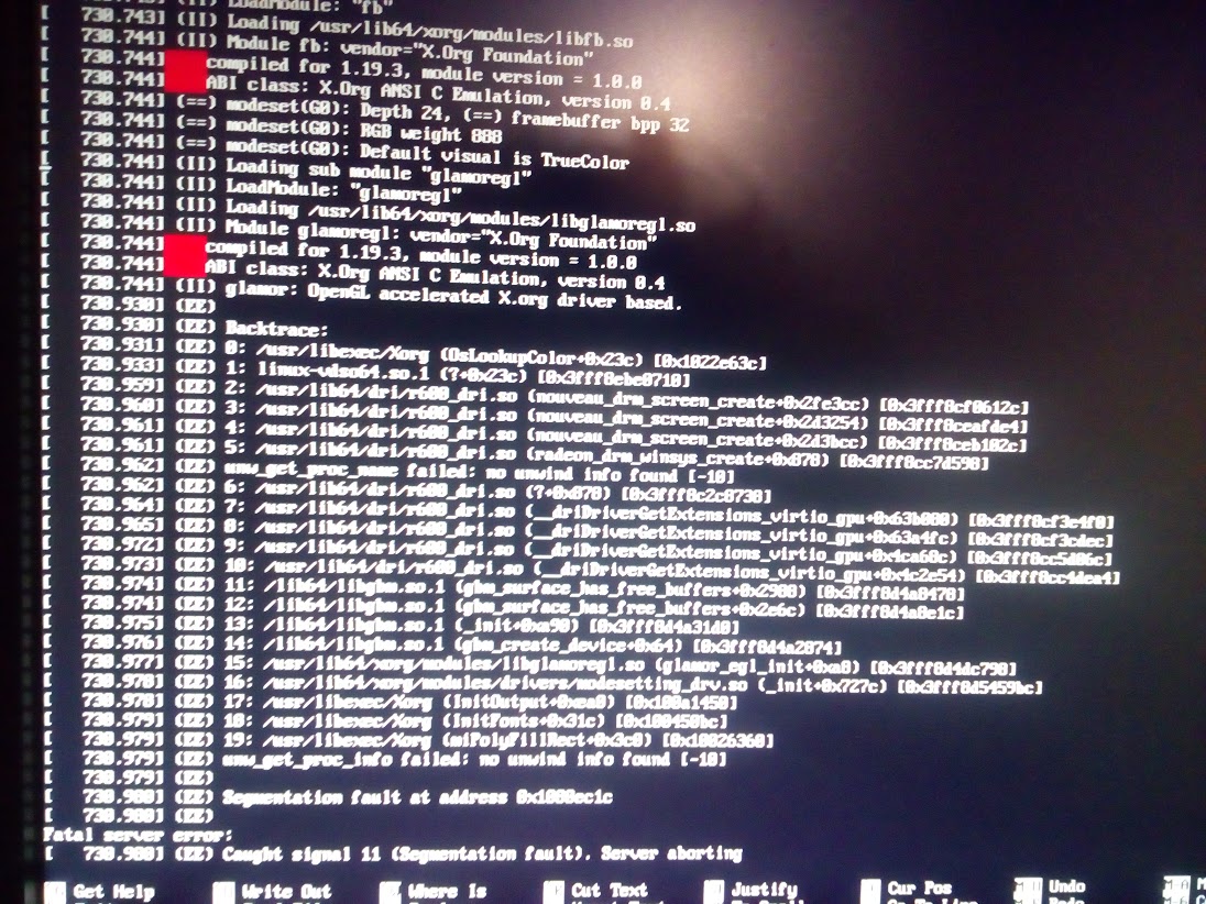

TearsOfMe wrote:Added screenshot. Used startx. Xorg -configure give me the same seg fault error.
Hi TearsOfMe,
Do you need the boot argument 'rw' for booting Fedora? Could you please post the Xorg log? (/var/log/Xorg.0.log)

First i upgrade with your instructions from here. Xorg works not and i decided to
wipe the partition and dd the fedora26.img from supertux homepage.

TearsOfMe,
Did you test it with the radeon driver as well? Could you please post your xorg.conf?
Posts: 11170
Re: Fedora 26 Server PPC64
Maybe glamor is the problem (see your photo).
Posts: 11170
I hope this will help.

The xorg.conf and log attached.
P.S.: dd the image again so xorg.conf is like in the image again.
The disabled glamore xorg.conf works also not.

Hi TearsOfMe,
Could you please post the Xorg log after disabling glamoregl? (/var/log/Xorg.0.log)
