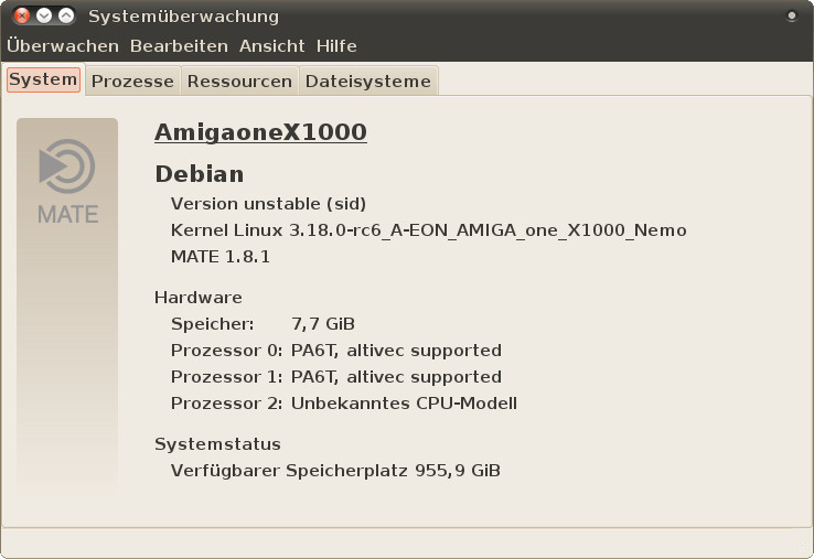

New Nemo kernel config for the RC6:
nemo_3.18.0-rc6_KVM-PR_OVERLAYFS.config.tar.bz2
(16.1 KiB) Downloaded 1495 times
