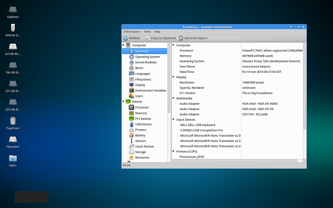

Then I solved the problem of missing text (fonts).It seems that My installation lacked a folder of fonts in / etc/X11/fonts. It was the 75 dpi folder and I then copied it over from my ubuntu 12.04. Then I booted Ubuntu 14 again and log in to Lubuntu and xfce where everything worked except for a few error messages.
(357.98 KiB) Downloaded 154 times

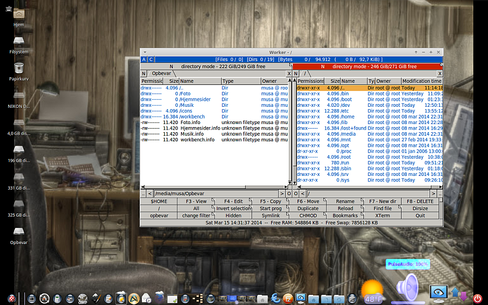

I have some problems with the colors in all my Linux installations (Debian, Ubuntu 12.04, 12.10 and 14.04) This relates in particular to the transparent colors as in the audio icon as seen in the attached screenshot. Do you have any idea what it was due and whether it can be corrected?
(674.53 KiB) Downloaded 99 times
