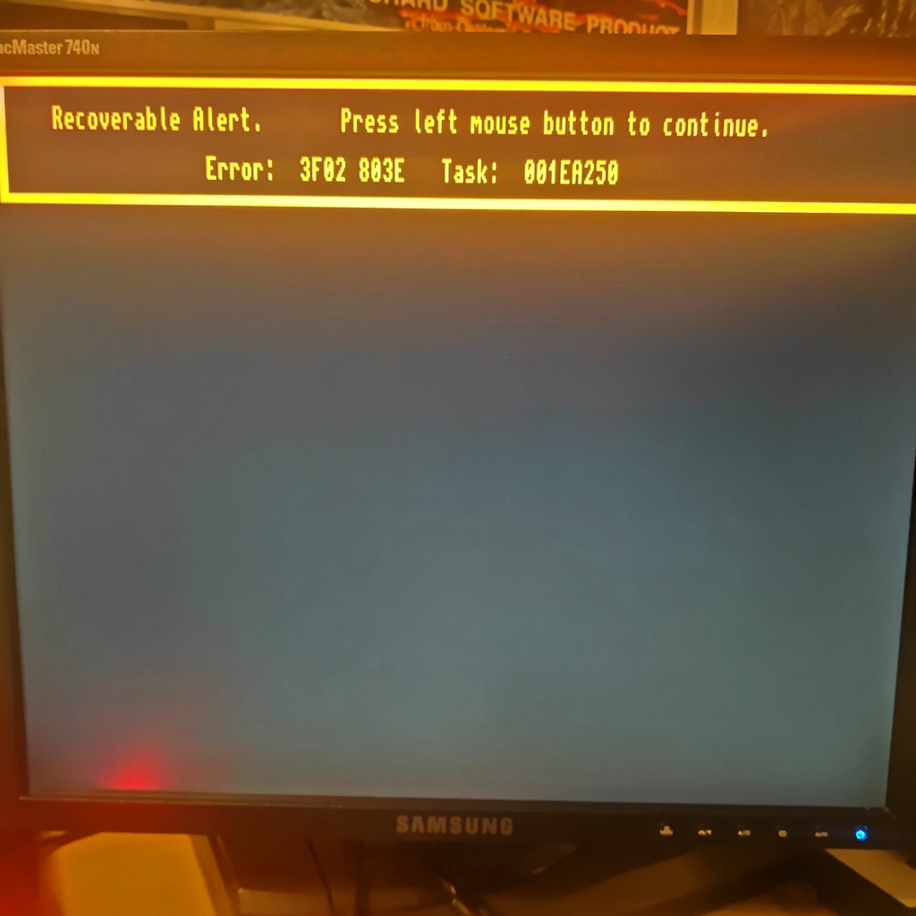

Hi Folks,
Kickstart/OS 3.2.2.1 and Kickstart/OS 1.3 both boot without an error for me, but Kickstart 3.2.3 is having trouble that Im hoping someone can point me in the right direction please.
I have a Phoenix Amiga 1000 with a TF536 '030 card (64Mb), an X-Surf 4 Phoenix card, a ZuluSCSI sttached to the builtin SCSI port (its very slow on the Phoenix), and an ECSv4 installed.
I wrote the Kickstart 3.2.3 to a 27C240, 100ns ROM which the Phoenix allows in ROM # 4 (Rom #1 is an original kickstart 1.3, Rom #2 is a purchased OS 3.2, and ROM # 3 is unused).
When OS 3.2.3 boots, it seems to work fine, but most of the time I am getting errors similar to the attached (Error: 3F02 803E Task: 001EA250) - the task number seems to change. If I leave it, it will continue to start workbench, I then always get the error in the second pic (Program failed (error #8000000B).
But if it boots, without these errors, it is fine.
Is my ROM (the 27C240) too fast at 100ns? Is there something else I can look at to track down the problem?
Any help appreciated.

Re: 3.2.3 Crash on startup
Thanks for the reply.
Yes, I can soft-boot without an issue, and that is what I am using now with a Kick 3.2 ROM. Which means I get the extra reboot at startup.
Interestingly, when I am using the 3.2.3 ROM in ROM #4, it does not show any expansions in the boot menu, but when it boots and runs correctly, all expansions are detected and in use in Workbench.
I have created a DiagROM v2 ROM and popped it into ROM #4, it runs ok and does not report any errors running tests, which gives me some comfort.
I have purchased a 3.2.3 ROM from 2 different vendors, and waiting for them to arrive, hoping its just another quirk of my Phoenix and that regular ROMS in ROM #1 or ROM #2 sockets (the standard ROM sockets) will work better.
Hi,
I took out my Kickstart 3.2.2 which has been working perfectly, and wrote the A500 512k 3.2.3 bin to the 27c400 120ns eprom.
It has the same problem as the 27c240 @ 100ns. When it boots without a Software Error, the Amiga runs flawlessly and for hours without failure. If I need to soft-reset or doer a hard-reset however, I get the Software Error in the original post. Doing further soft-resets, and even turning the Amiga off and back on does not immediately help. Eventually I get back in, and everything works (took about 5-7 reboots).
I may have more success when I leave the Amiga off for a few hours and then boot again - but I have to test this theory more yet. Once it gets the Software Error, turning off even for a few minutes and back on does not seem to help.
I have also observed that when the Software Error occurs, if I reset and hold down both mouse buttons to get the boot menu, none of my expansions appear in the boot menu. It should show the TerribleFire 536, Phoenix SCSI, and an X-Surf expansions. When it boots without an error, the expansions are all available and work perfectly in Workbench. Workbench and various tools validate my kickstart is v47.115. When I was booting with the 3.2.2 ROM, they all showed the ROM as 47.111, but the Workbench title would say 3.2.3.
On boot, It looks like it is reading the Startup-Sequence before the Software Error comes up, but never makes it to the User-startup (I know this, because I have sound file that plays with play16 at the beginning of my User-startup to give me a clue of how far it has got). My Startup Sequence does load MuFastROM with PROTECT ON if that helps?
Again, the 3.2.2 kickstart ROM has none of these Software Error issues, and boots everytime.
So then, to see where s-s fails, you can try to boot with TRACE mode enabled.
Can the order of attached cards be change ?
Would be interesting to see ShowConfig output for your hardware under 3.2.2 and then 3.2.3 rom
that could shed some light as to what is allocated where
I booted the first time this morning with TRACE on and it booted fine, but then did a soft-reset and turned TRACE on again - this time it came up with an error there was not enough memory to run Version exec.library version 48 (see screenshot)?
The 'Expansion Board' screen is not showing any expansion boards in the boot menu which it used to do with previous kickstarts (i.e 3.2.2). If I now reboot without TRACE, I get the Software Error screen from the first post.
I powered off my machine, left it for 5-10 minutes, and powered back on, it now boots again OK. I am unable to upload the showconfig report (.txt is an invalid filename extension?) so I have copied and pasted it below:

The only card that is moveable in this config is really the LAN card (X-Surf). I have another LAN card (a Zorro-LAN-IDE-CP card by Matze) which I have swapped into the Phoenix, but there is no difference, same error.
Today I will downgrade from 3.2.3 back to 3.2.2 where this problem did not occur. I'd love to know what changed in 3.2.3 that causes this issue.
I have also a Vampire 500 V2 coming, and will try to swap out the TF536, and put 3.2.3 on the Vampire.
Today I reverted my kickstart back to 3.2.2 (47.111) after erasing and then writing the bin file to the same 27c400 eprom that had the 3.2.3 (47.115). The Expansions all appear again in the (pre) Boot menu now when the "Expansion" button is pressed (this was showing no expansions/blank with the 3.2.3 kickstart rom).
The boot problems have disappeared, and the Amiga is working reliably again. I have the extra reboot at startup of course.
Below is the ShowConfig log now from 3.2.2, still running Workbench 3.2.3. This config shows that I have the Matze, Zorro-LAN-IDE card in rather than the X-Surf which I swapped earlier in a further attempt to troubleshoot the 3.2.3 kickstart rom (neither card changed the Amiga boot behaviour). I also tried adding a WAIT into my startup sequence in case the cards needed more time to initialise under 3.2.3, but this also made no difference. From my POV, there is something different in the 3.2.3 ROM - any ideas what it might be?
ShowConfig log:
