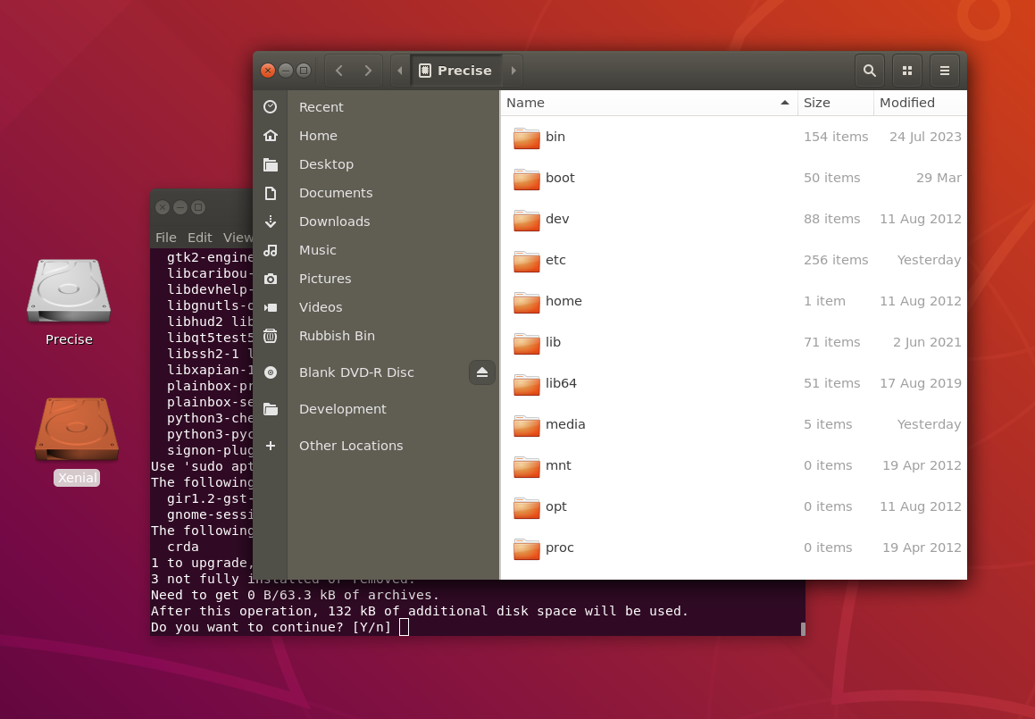

Okay I got somewhere. It finally downloaded all packages it needed. Then started the slow process of installing the packages...
I had ran it from a terminal on the desktop. After it had installed a heap of packages the system noticed it had been updating. The Software Updater loaded and said there was some problem and that I could do a partial upgrade. At this point I though it best to reboot. So logged out and restarted.
Upon reloading it looked promising. A pointer appeared. But then it delayed for too long. Went to a terminal. But then it snatched it away again. Back to terminal and type. It snatched it away again! I don't know how they design these things to be so unusable when things don't work. If it has problems loading a desktop why does it go into a loop trying to constantly load a desktop!? Duh! :?:
It was even worse than I thought. There was no internet! I pressed reset combo to get out and then booted into Xenial to fix it. I did a chroot to it and it still had problems. It didn't have host internet from a chroot either. It was going downhill. I realised I hadn't installed any modules. So I coped both 5.10.235 and 6.15-RC1 over. In the meantime I kept doing the apt install dist-upgrade. I also had an inkling the desktop issue was due to lacking 3d hardware support which gnome 3 requires. So also tried an apt install gnome-shell and apt install gnome-flashback. It had cached enough packages so they could be installed. I found the gnome-flashback package can help alleviate desktop issues. It also installed all these other packages in the meantime.
I logged out of the chroot and rebooted into the system again using kernel 6.15-RC1. I had upgraded it with 5.10.235. This time it could boot! Plus the internet was back. It loaded the desktop! I could see the difference. Some things like icons are enlarged which looks strange. But others like user widget are missing from menu bar. I tried to continue the apt install dist-upgrade. It got further but broke on this:
Unpacking crda (3.18-1build1) over (3.13-1) ...
dpkg: error processing archive /var/cache/apt/archives/crda_3.18-1build1_powerpc.deb (--unpack):
 trying to overwrite '/lib/crda/pubkeys/sforshee.key.pub.pem', which is also in package wireless-regdb 2020.11.20-0ubuntu1~16.04.2
Errors were encountered while processing:
Apparently it's an old bug. I don't use a wireless card so could just remove it. But for now here's a screen shot! :-D
