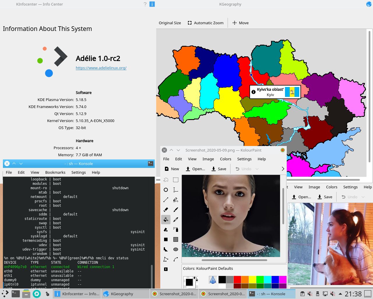

World premier: Adélie Linux 1.0-rc2 with KDE Plasma desktop running on X5000 ;-).
Posts: 11066
Re: Adélie Linux
Roland wrote: Thu Apr 21, 2022 4:00 pm World premier: Adélie Linux 1.0-rc2 with KDE Plasma desktop running on X5000 ;-).
This is great! Thanks for the screenshot!
