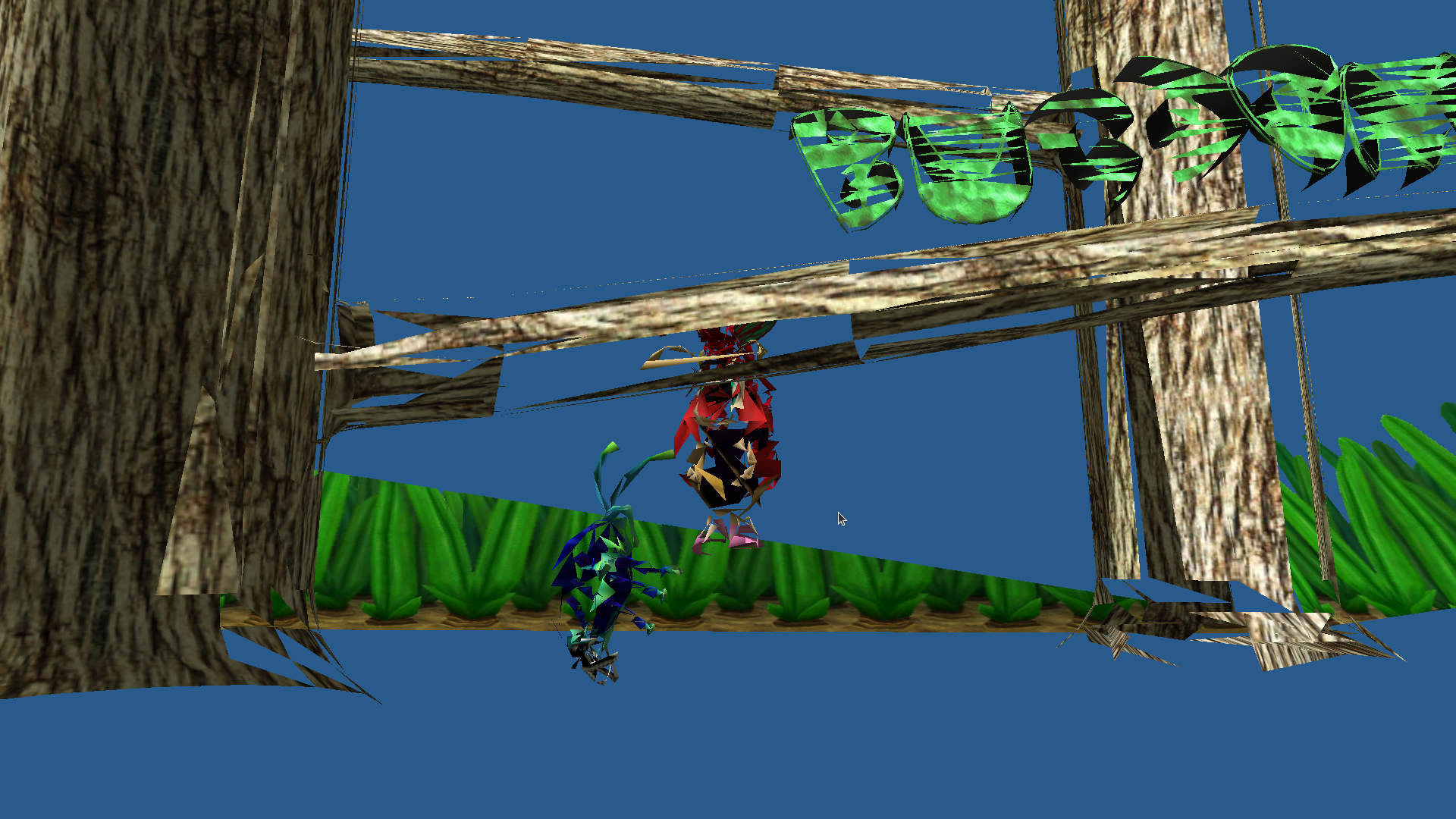

My textures are broken using my ATI X1900.
Big picture https://www.skateman.nl/wp-content/uplo ... -32-52.png
This seem to be the issue with most games at the moment.

Skateman wrote: Sat Apr 29, 2023 12:38 pm My textures are broken using my ATI X1900.
Thank you for testing. Yes, there are graphical issues in some games if you use ATi Radeon X1900 and X1950 graphics cards. :-(

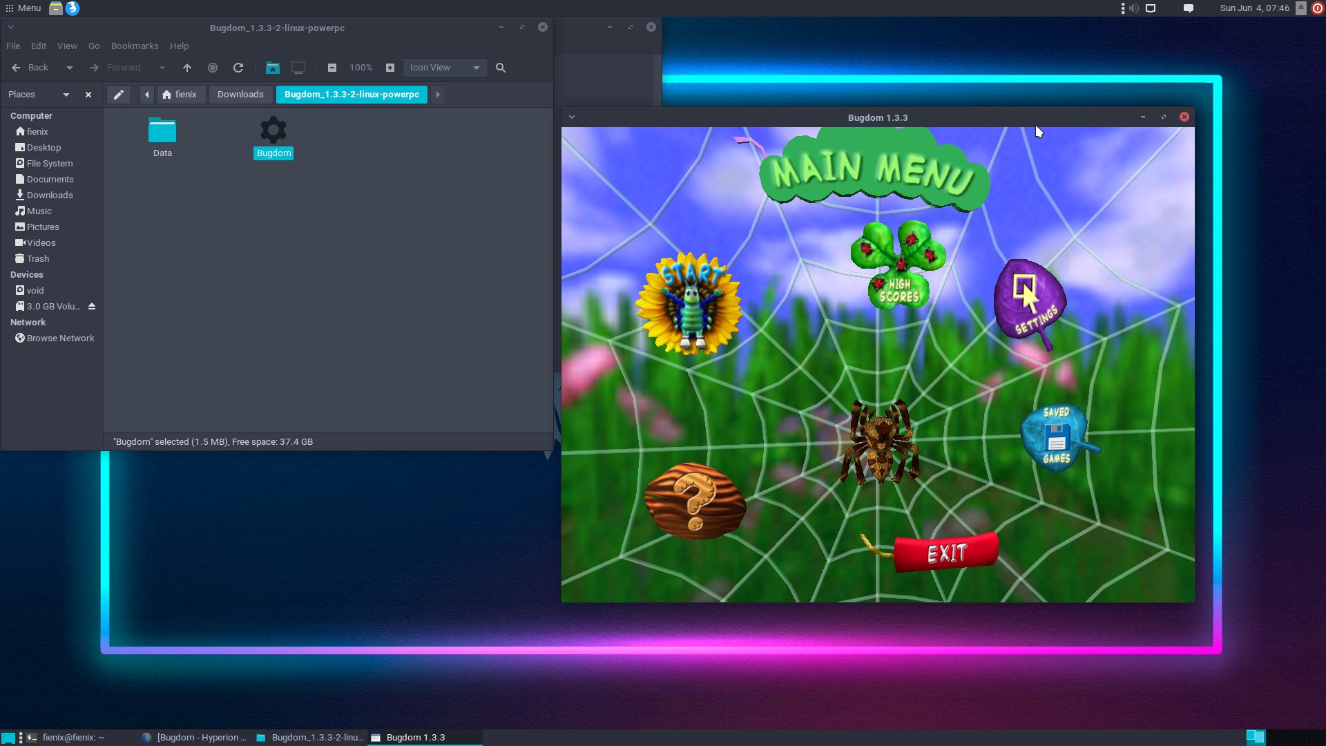

Posts: 954
Re: Bugdom
Yess,
The patched version of Bugdom is also running fine!!
Best thing is that we now know where this issue is coming from
big picture https://www.skateman.nl/wp-content/uplo ... -46-55.png
