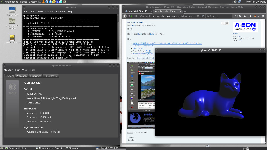

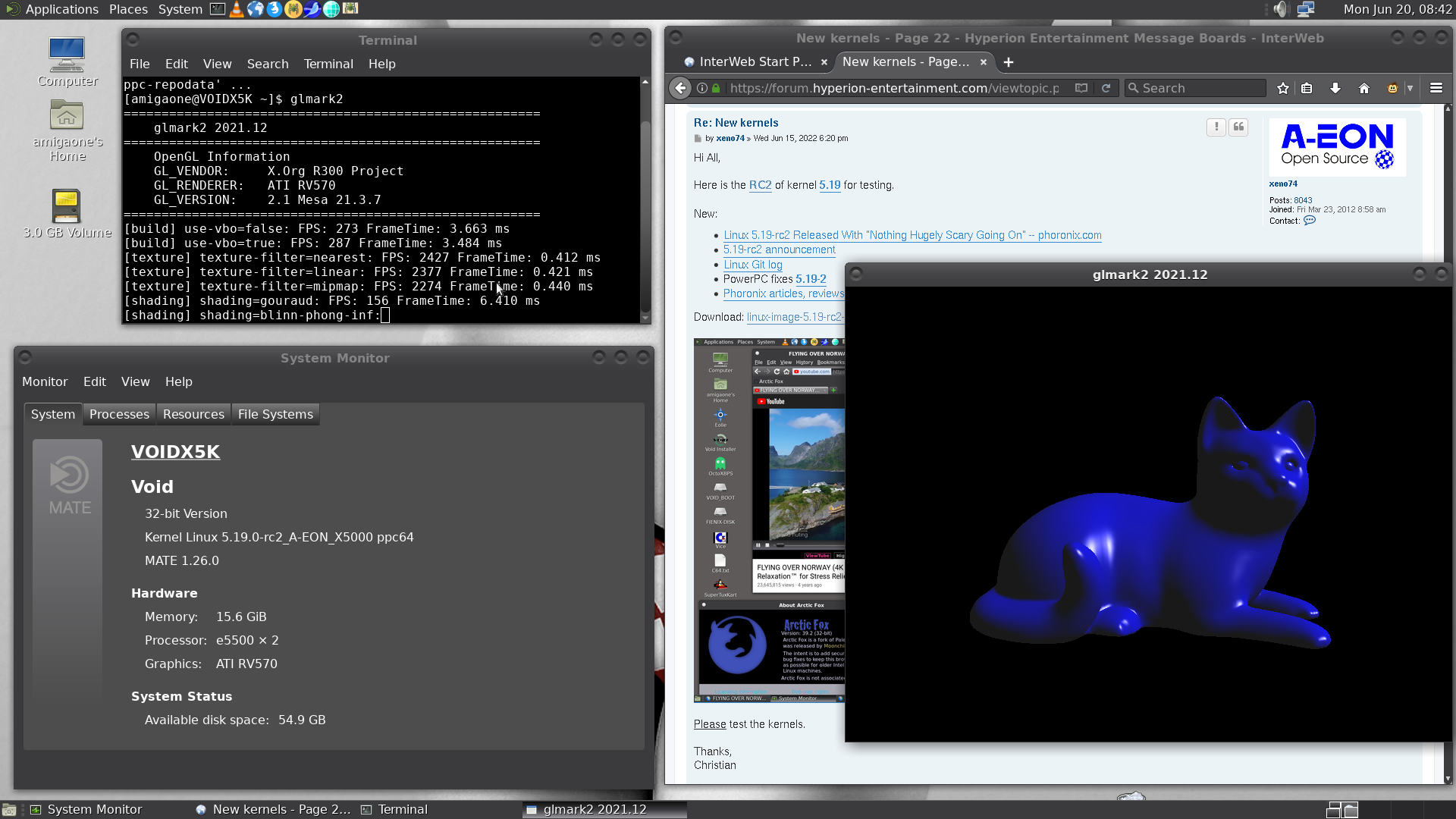

Posts: 954
Kernel 5.19 RC2 up and running on my AmigaOne X5000
Big picture https://www.skateman.nl/wp-content/uplo ... -42-51.png
Posts: 10698
Skateman wrote: Mon Jun 20, 2022 8:47 am Kernel 5.19 RC2 up and running on my AmigaOne X5000
Many thanks for testing! :-)

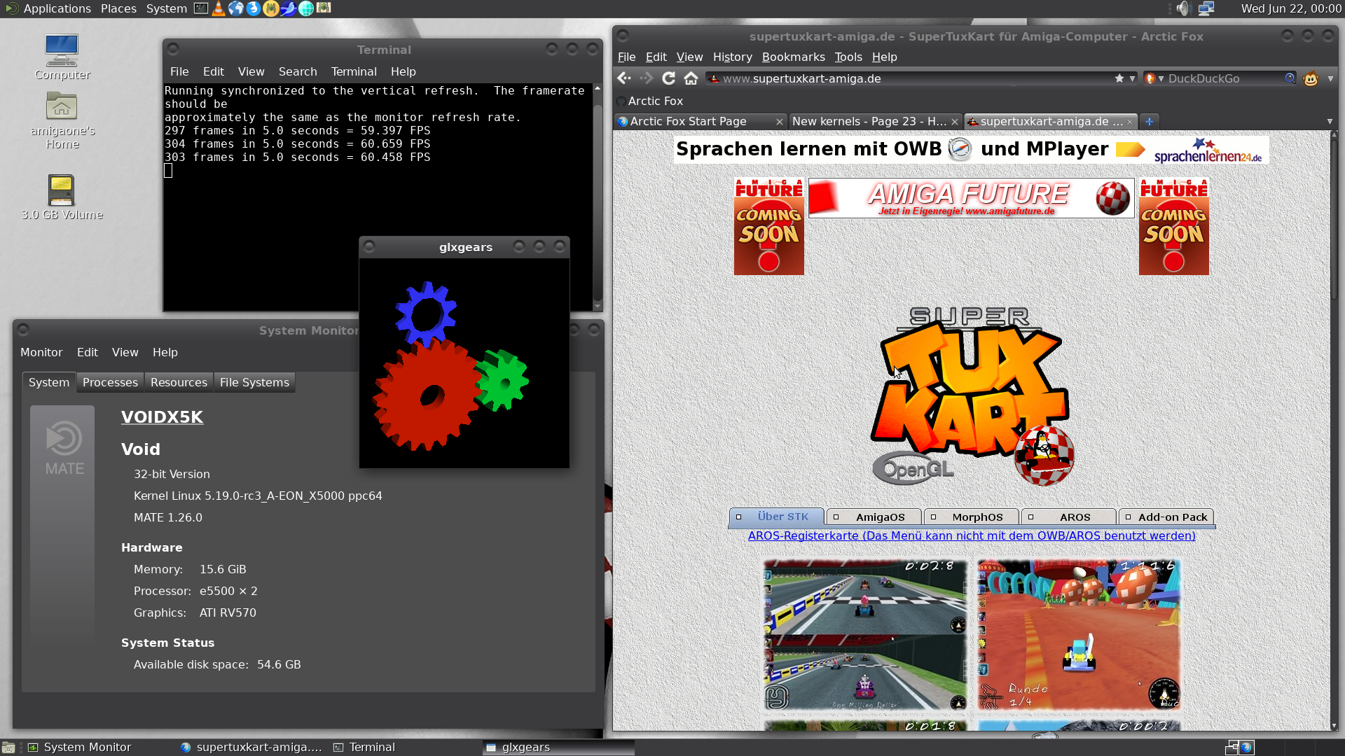

Posts: 954
Kernel 5.19 RC3 is running fine on my AmigaOne X5000
Big picture https://www.skateman.nl/wp-content/uplo ... -00-47.png
Posts: 10698
Skateman wrote: Wed Jun 22, 2022 12:04 am Kernel 5.19 RC3 is running fine on my AmigaOne X5000
Great! Thanks a lot for testing!
