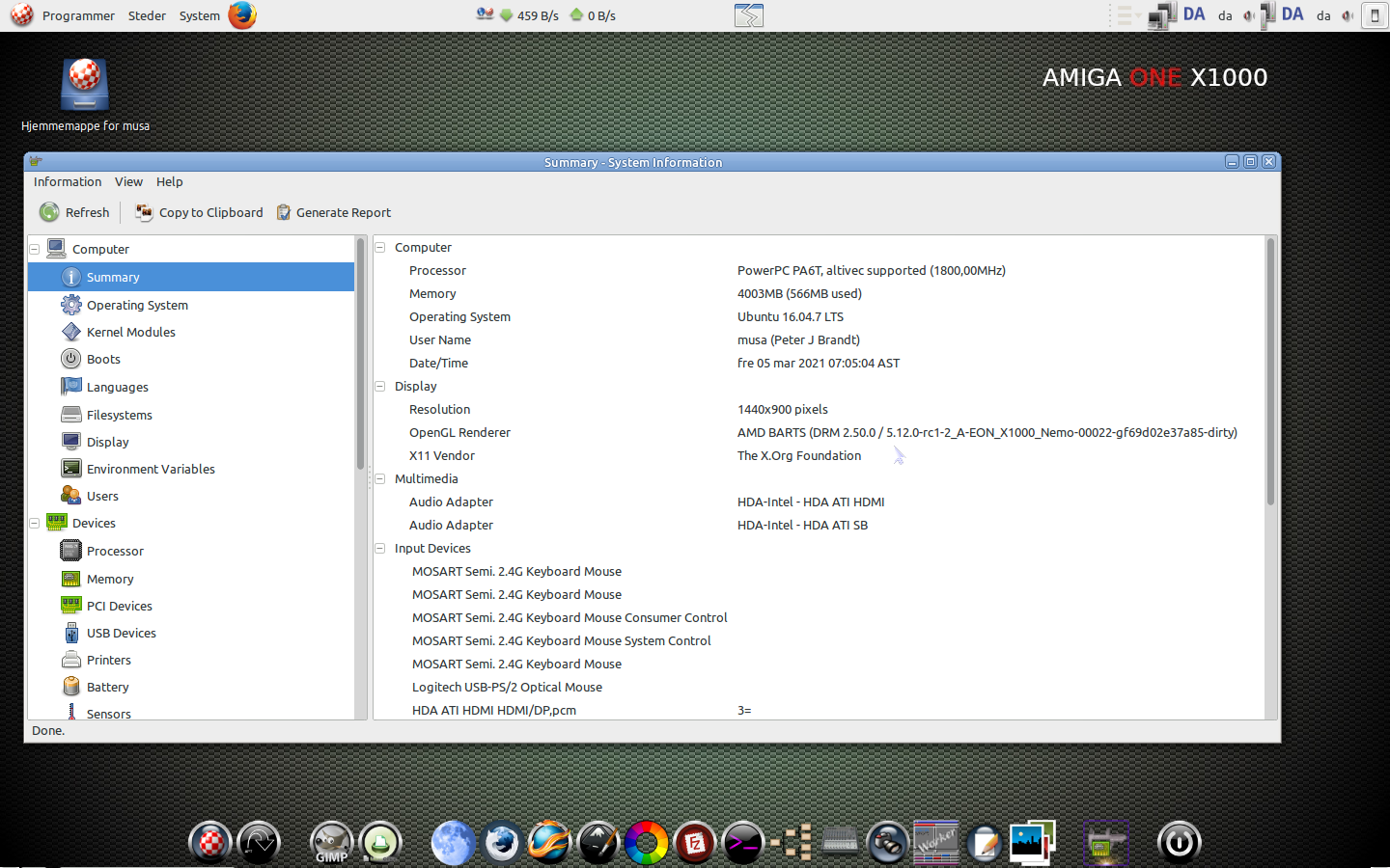

Hi hristian
Here is ubuntu 16.04 with kernel 5.12-rc1-2. Boot with a lot of error messages that I do not think had anything to do with the kernel. Afterwards, I lost access to my hard drive 3 with most of my Linux partitions. Back are Ubuntu 16.04 and Fienix. I have now inserted a new larger completely empty hard drive and formatted it in several partitions. Can I move my Fienix partition to a new empty partition on the new hard disk with the DD command? Or are there any better methods?
Have a nice day
Have a nice day
