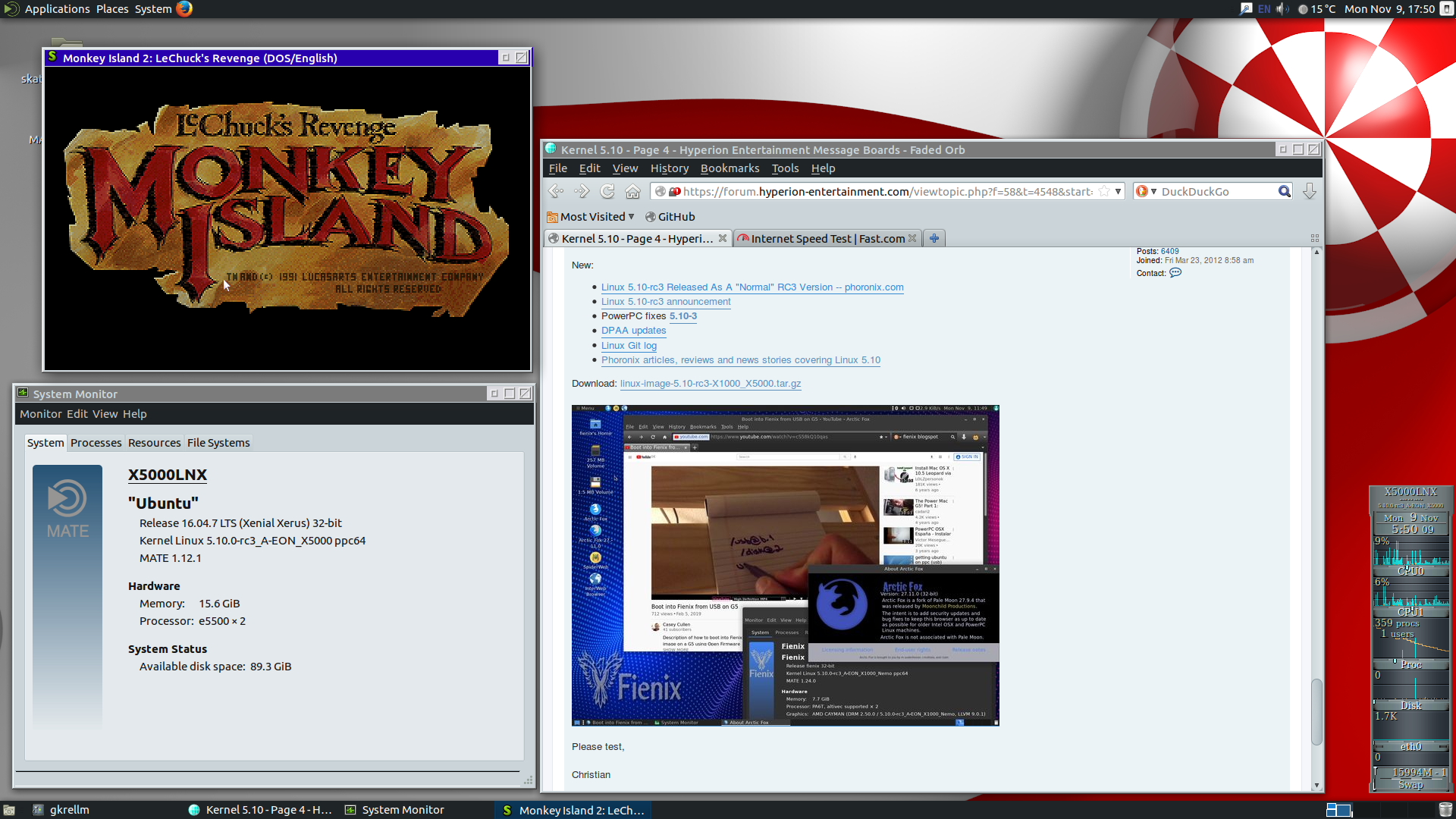

Kernel 5.10 RC3 running fine on the AmigaOne X5000
Big picture http://www.skateman.nl/wp-content/uploa ... 175009.png

Skateman wrote: Mon Nov 09, 2020 4:54 pm Kernel 5.10 RC3 running fine on the AmigaOne X5000
Thanks a lot for testing the RC3! I was curious because of the latest DPAA updates but they seem to work on your X5000. :-)
