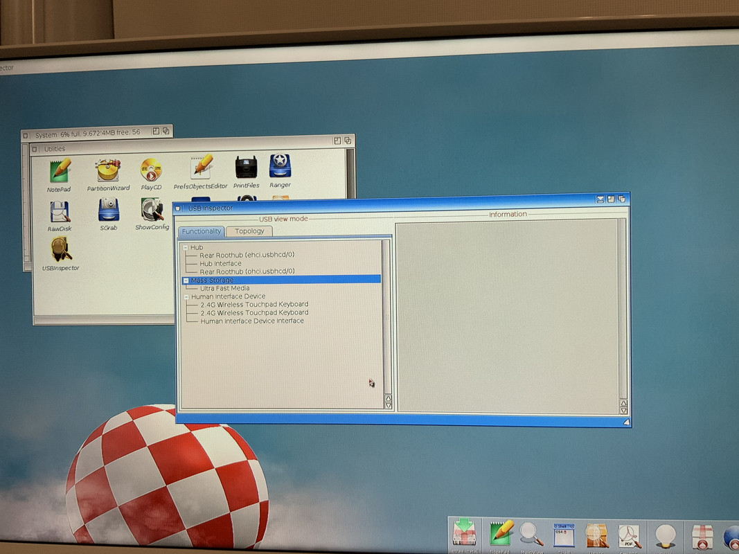

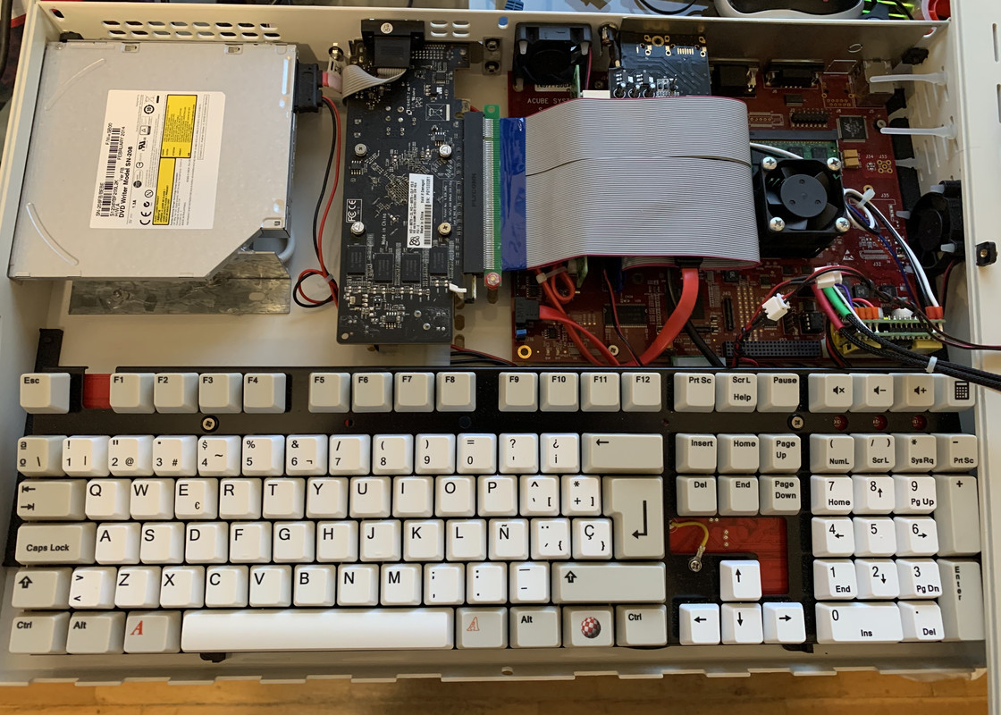

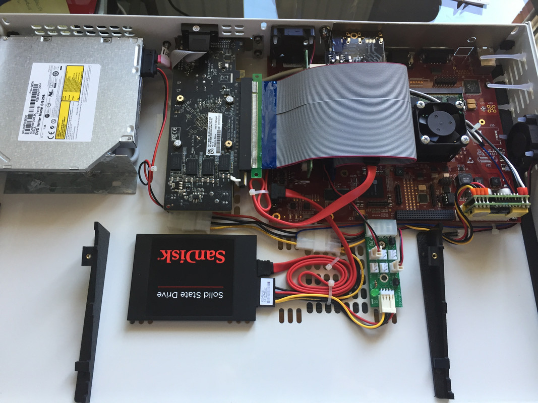

I have a Sam460ex motherboard, with Amiga OS 4.1 installed on a SSD connected via SATA.

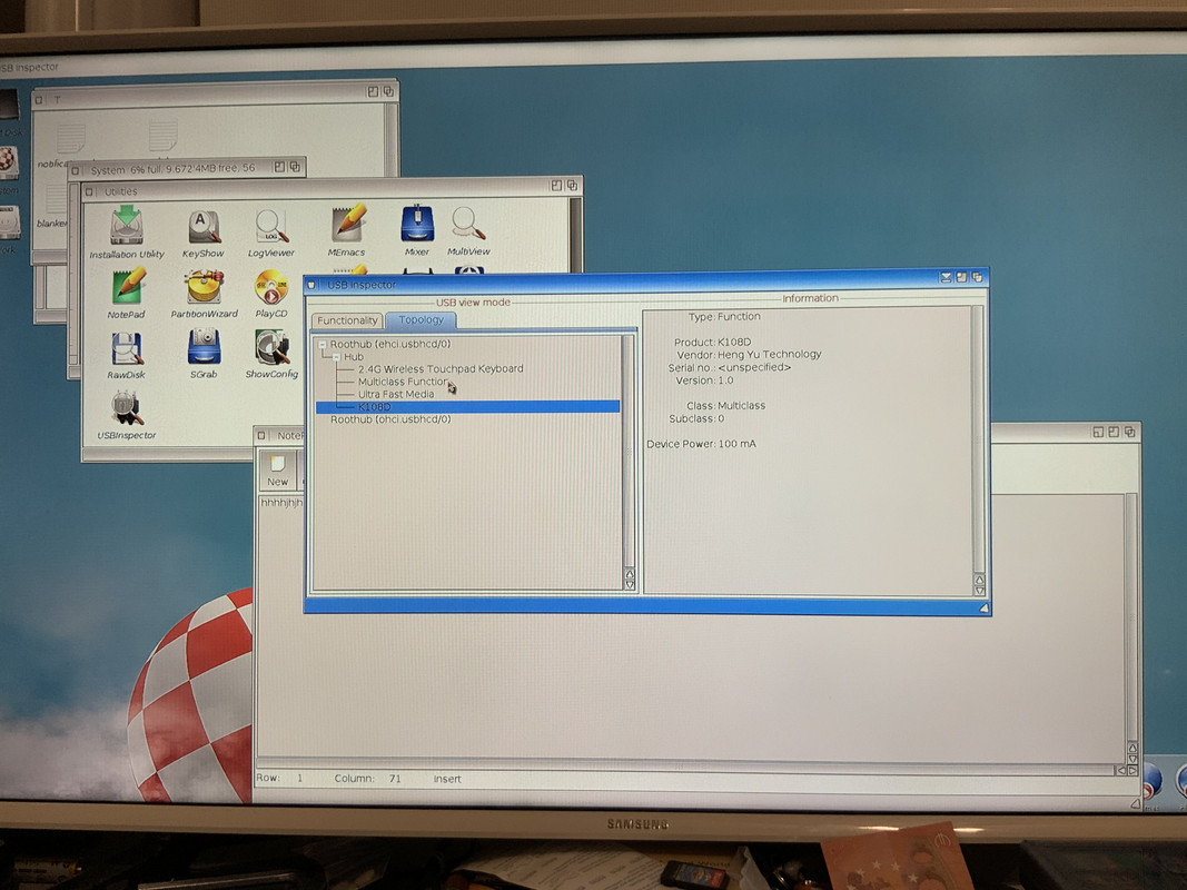

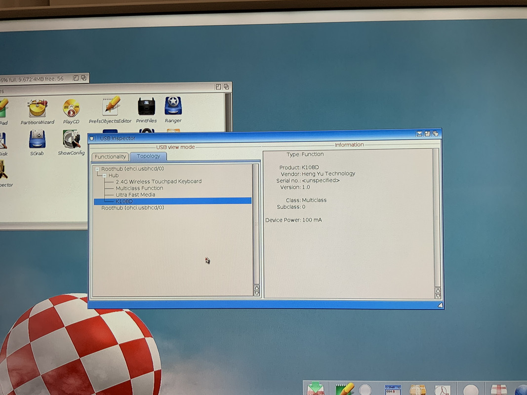

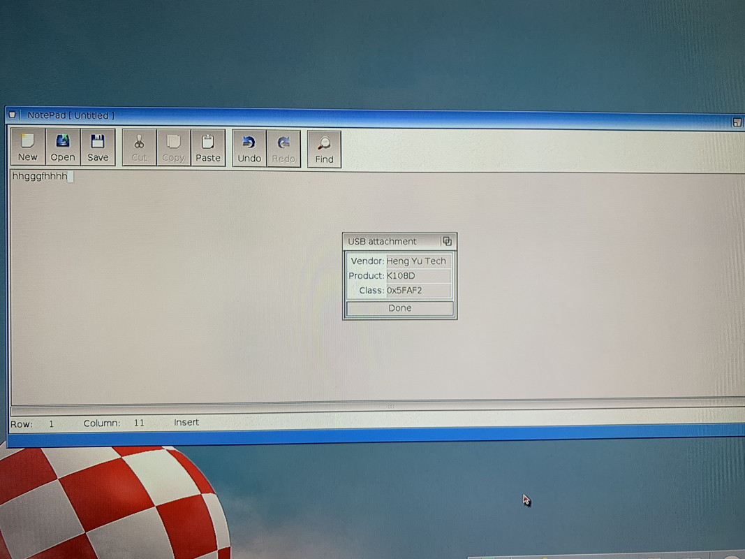

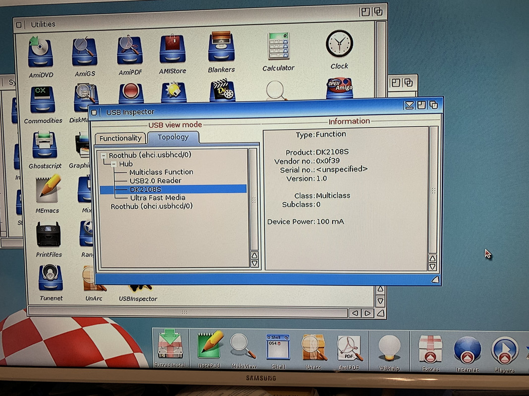

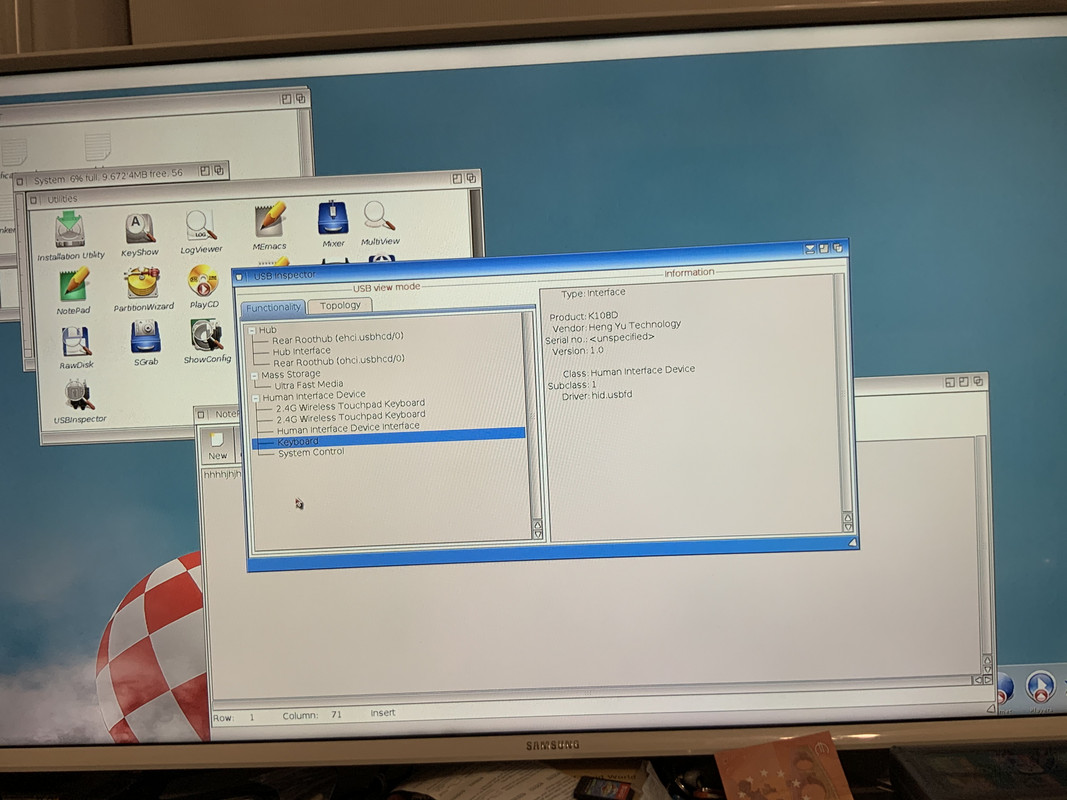

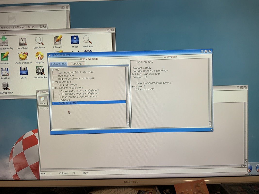

And I'm having problems with a keyboard connected to the internal USB ports of the motherboard.
When AmigaOS 4.1 boots, the keyboard is (almost always) not (completely)recognized. If I disconnect and reconnect the keyboard a couple of times it's finally recognized, numlock lights up and the keystrokes are recognized. If after the keyboard works, I disconnect and reconnect it again, it's not recognized again.

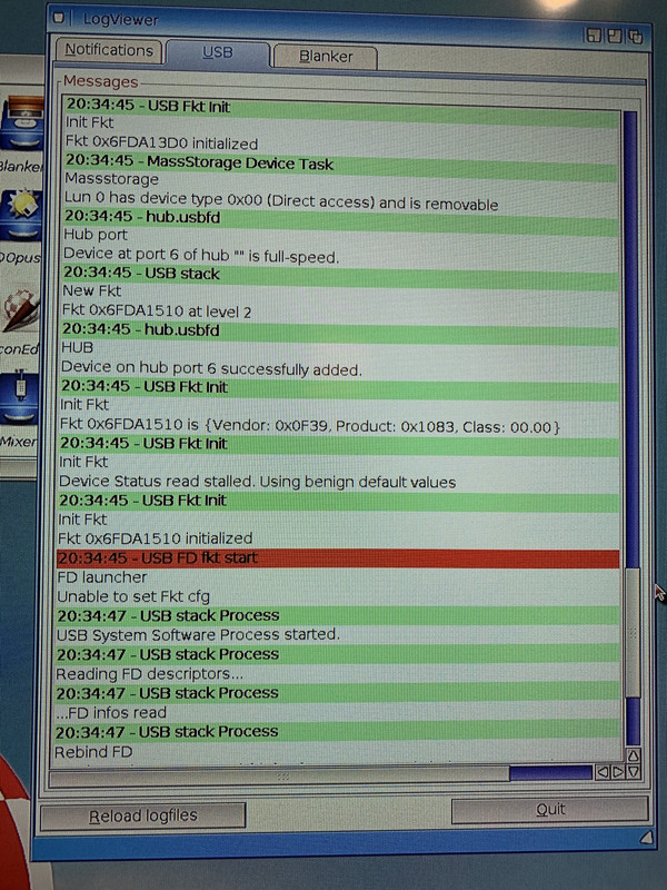

Here is what usb.log says. I've highlighted in red the 'keyboard events' when I'm disconnecting and reconnecting on various ports (J13a and J13b) it until it works.

I: [20:41:21] USB Fkt Init | Init Fkt | Fkt 0x6FDA1510 is {Vendor: 0x0F39, Product: 0x1083, Class: 00.00}
I: [20:41:21] USB Fkt Init | Init Fkt | Device Status read stalled. Using benign default values
I: [20:41:21] USB Fkt Init | Init Fkt | Fkt 0x6FDA1510 initialized
E: [20:41:21] USB FD fkt start | FD launcher | Unable to set Fkt cfg

I: [20:44:35] USB stack | New Fkt | Fkt 0x6013b990 at level 2
I: [20:44:35] USB stack | New Fkt | HCD failed to add/create Fkt
W: [20:44:35] hub.usbfd | HUB | Retrying attachment on port 5 of hub "" (previous attempt failed with error -19)
W: [20:44:35] hub.usbfd | HUB | Resetting hub port 5 and trying again
I: [20:44:36] hub.usbfd | HUB | Port 5 of hub "" reset timed out
W: [20:44:36] hub.usbfd | HUB | Resetting hub port 5 and trying again
W: [20:44:36] hub.usbfd | HUB | Hub port 5 attachment was not possible
E: [20:44:36] hub.usbfd | HUB | Resetting port 5 of hub "" failed. Device adding aborted
I: [20:44:36] hub.usbfd | HUB | Unable to reset hub port.
Device adding aborted.
I: [20:44:39] hub.usbfd | HUB | Device found on port 6 of hub "".
I: [20:44:39] hub.usbfd | HUB | No device on port 6 of hub "" after reset
W: [20:44:39] hub.usbfd | HUB | Resetting hub port 6 and trying again
I: [20:44:40] hub.usbfd | HUB | Port 6 of hub "" reset timed out
W: [20:44:40] hub.usbfd | HUB | Resetting hub port 6 and trying again
I: [20:44:41] hub.usbfd | HUB | Port 6 of hub "" reset timed out
W: [20:44:41] hub.usbfd | HUB | Hub port 6 attachment was not possible
E: [20:44:41] hub.usbfd | HUB | Resetting port 6 of hub "" failed. Device adding aborted
I: [20:44:41] hub.usbfd | HUB | Unable to reset hub port.
I: [20:44:41] hub.usbfd | HUB | Device found on port 6 of hub "".
I: [20:44:41] hub.usbfd | Hub port | Device at port 6 of hub "" is full-speed.
I: [20:44:41] USB stack | New Fkt | Fkt 0x6013b990 at level 2
I: [20:44:41] hub.usbfd | HUB | Device on hub port 6 successfully added.
I: [20:44:41] USB Fkt Init | Init Fkt | Fkt 0x6013b990 is {Vendor: 0x0F39, Product: 0x1083, Class: 00.00}
I: [20:44:41] USB Fkt Init | Init Fkt | Device Status read stalled. Using benign default values
I: [20:44:41] USB Fkt Init | Init Fkt | Fkt 0x6013b990 initialized
E: [20:44:41] USB FD fkt start | FD launcher | Unable to set Fkt cfg
I: [20:44:53] hub.usbfd | HUB | Detaching Function removed from hub port 6
I: [20:44:53] hub.usbfd | HUB | Device found on port 6 of hub "".
I: [20:44:53] hub.usbfd | Hub port | Device at port 6 of hub "" is full-speed.
I: [20:44:53] USB stack | New Fkt | Fkt 0x6013b990 at level 2
I: [20:44:53] USB stack | New Fkt | HCD failed to add/create Fkt
W: [20:44:53] hub.usbfd | HUB | Retrying attachment on port 6 of hub "" (previous attempt failed with error -19)
W: [20:44:53] hub.usbfd | HUB | Resetting hub port 6 and trying again
I: [20:44:54] hub.usbfd | HUB | Port 6 of hub "" reset timed out
W: [20:44:54] hub.usbfd | HUB | Resetting hub port 6 and trying again
W: [20:44:54] hub.usbfd | HUB | Hub port 6 attachment was not possible
E: [20:44:54] hub.usbfd | HUB | Resetting port 6 of hub "" failed. Device adding aborted
I: [20:44:54] hub.usbfd | HUB | Unable to reset hub port.
I: [20:44:54] hub.usbfd | HUB | Device found on port 6 of hub "".
I: [20:44:54] hub.usbfd | Hub port | Device at port 6 of hub "" is full-speed.
I: [20:44:54] USB stack | New Fkt | Fkt 0x6013b990 at level 2
I: [20:44:55] hub.usbfd | HUB | Device on hub port 6 successfully added.
I: [20:44:55] USB Fkt Init | Init Fkt | Fkt 0x6013b990 is {Vendor: 0x0F39, Product: 0x1083, Class: 00.00}
I: [20:44:55] USB Fkt Init | Init Fkt | Device Status read stalled. Using benign default values
I: [20:44:55] USB Fkt Init | Init Fkt | Fkt 0x6013b990 initialized
E: [20:44:55] USB FD fkt start | FD launcher | Unable to set Fkt cfg
I: [20:57:37] hub.usbfd | HUB | Detaching Function removed from hub port 6
I: [20:57:37] hub.usbfd | HUB | Device found on port 6 of hub "".
I: [20:57:37] hub.usbfd | HUB | Port 6 of hub "" reset timed out
W: [20:57:37] hub.usbfd | HUB | Resetting hub port 6 and trying again
I: [20:57:38] hub.usbfd | HUB | Port 6 of hub "" reset timed out
W: [20:57:38] hub.usbfd | HUB | Resetting hub port 6 and trying again
W: [20:57:38] hub.usbfd | HUB | Hub port 6 attachment was not possible
E: [20:57:38] hub.usbfd | HUB | Resetting port 6 of hub "" failed. Device adding aborted
I: [20:57:38] hub.usbfd | HUB | Unable to reset hub port.
I: [20:57:41] hub.usbfd | HUB | Device found on port 5 of hub "".
I: [20:57:41] hub.usbfd | Hub port | Device at port 5 of hub "" is full-speed.
I: [20:57:41] USB stack | New Fkt | Fkt 0x6013b990 at level 2
I: [20:57:41] hub.usbfd | HUB | Device on hub port 5 successfully added.
I: [20:57:41] USB Fkt Init | Init Fkt | Fkt 0x6013b990 is {Vendor: 0x0F39, Product: 0x1083, Class: 00.00}
I: [20:57:41] USB Fkt Init | Init Fkt | Device Status read stalled. Using benign default values
I: [20:57:41] USB Fkt Init | Init Fkt | Fkt 0x6013b990 initialized
E: [20:57:41] USB FD fkt start | FD launcher | Unable to set Fkt cfg
I: [20:57:49] hub.usbfd | HUB | Detaching Function removed from hub port 5
I: [20:57:50] hub.usbfd | HUB | Device found on port 5 of hub "".
I: [20:57:50] hub.usbfd | Hub port | Device at port 5 of hub "" is full-speed.
I: [20:57:50] USB stack | New Fkt | Fkt 0x6013b990 at level 2
I: [20:57:50] USB stack | New Fkt | HCD failed to add/create Fkt
W: [20:57:50] hub.usbfd | HUB | Retrying attachment on port 5 of hub "" (previous attempt failed with error -19)
W: [20:57:50] hub.usbfd | HUB | Resetting hub port 5 and trying again
I: [20:57:50] hub.usbfd | HUB | Port 5 of hub "" reset timed out
I: [20:57:51] hub.usbfd | HUB | Port 5 of hub "" reset timed out
W: [20:57:51] hub.usbfd | HUB | Resetting hub port 5 and trying again
I: [20:57:51] hub.usbfd | Hub port | Device at port 5 of hub "" is full-speed.
I: [20:57:51] USB stack | New Fkt | Fkt 0x6013b990 at level 2
I: [20:57:51] USB stack | New Fkt | HCD failed to add/create Fkt
W: [20:57:51] hub.usbfd | HUB | Retrying attachment on port 5 of hub "" (previous attempt failed with error -19)
W: [20:57:51] hub.usbfd | HUB | Hub port 5 attachment was not possible
E: [20:57:51] hub.usbfd | HUB | Failed to add device attached to hub port 5 due to error -19
I: [20:57:51] hub.usbfd | HUB | Hub driver was unable to

I hope someone knows….why AmigaOS randmonly recognizes it and randomly don't… The difference seems to be here:
NOT recognized:

I also attach some pics below, that might help
First, it seems strange to me that it shows a different value for 'class' in the first two pics:
Second, I only have this 3 things connected to the USB ports of the SAM 460ex: (no HDDs, pendrives, etc):
- External USB 1: USB Mouse
- External USB 2: USB Dongle for a 2,4Ghz Keyboard+Mouse
- Internal USB: The Ducky Zero Keyboard connected to one of the motherboard connectors.
When the keyboard is recognized: in 'Functionality' it is shown as 'Keyboard' and 'System control' and in 'Topology' as 'K108D'
This is what is shown when it is 'not recognized': nothing in 'Functionality', but still there in 'Topology' as 'K108D'.
Thank you!

From the attached log... do you see anything strange?
Thank you!

It was a matter of connecting the USB keyboard to a Windows PC (where it worked correctly every time), running the firmware updater and updating the keyboard (from S1886V15 to S1886V25). Firmware updated correctly and the keyboard still worked on Windows, so I hadn’t messed anything more than before.
I went on to connecting the keyboard to the internal USB port of the SAM460ex, booted AmigaOS 4.1 FE and …… IT WORKED!! I found that on the USB inspector… there were some differences:
- Before: it was shown as ‘K108D’ from vendor ‘Heng Yu Technology’ (as you can see on the screenshots attached on the posts above)
- Now: it is shown as ‘DK2108S’ from vendor ‘0x0f39’
Maybe the new firmware ‘negotiates’ better with the AmigaOS USB driver. So I don't know if anything needs (or can be) to be improved on the AmigaOS side…. The keyboard with the new firmware now works correctly on AmigaOS.

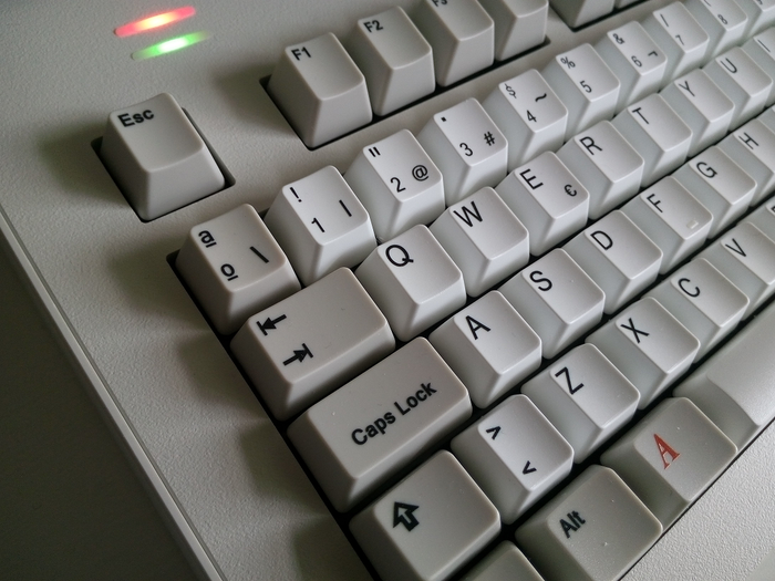

Finally, I leave here some pics of the system with Loriano Pagni (TheDaddy) case and keyboard.

During the OS install, the keyboard worked perfectly, but after the installation was done, the issues went back: it was only recognized randomly. At that point, I thought that maybe the AmigaOS’s USB driver wasn’t handling something right about this keyboard. Like @graff says, maybe it wasn’t giving the keyboard enough time or ‘retries' to properly attach.
I went on to Google to find if someone had experienced any issues with this type of keyboard (Ducky Zero DK2108S) on Windows on elsewhere, and I found that someone in reddit talked about a firmware update that solved some problems about one LED light blinking all the time. ((First time I’ve heard that keyboards had firmware updates. Good to know.)) The LED thing didn’t have any relation with my issue, but I gave it a try, and from Windows, I updated the keyboard’s firmware.
Thank you all for your
