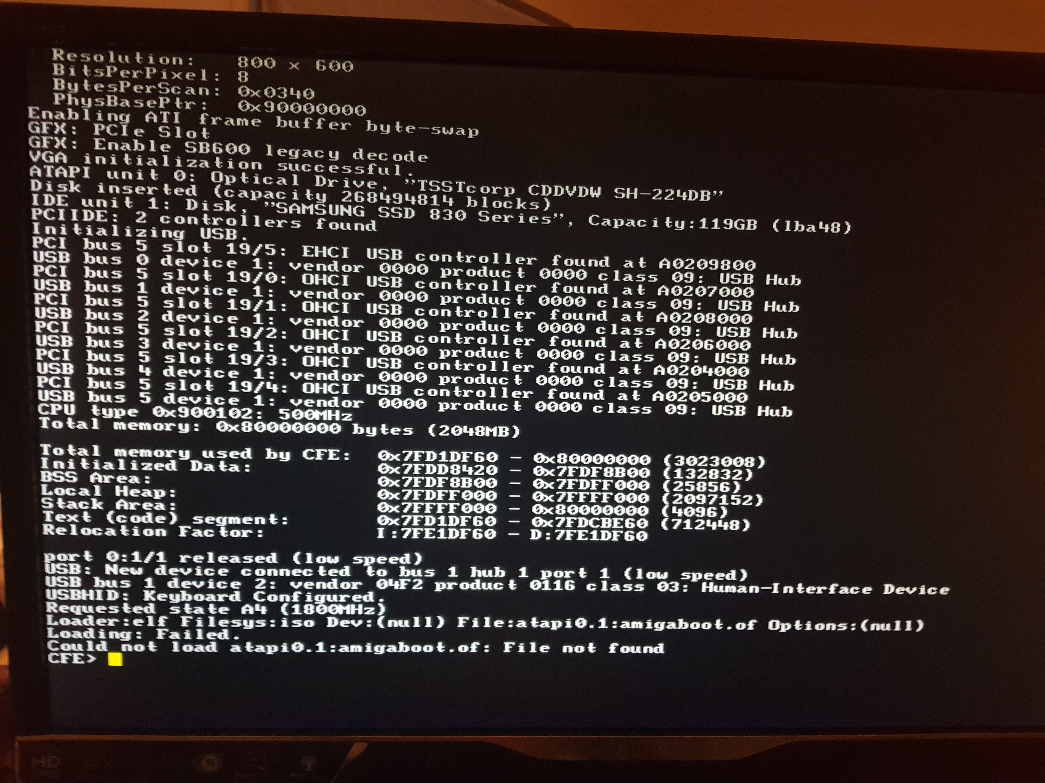

A few years ago, i was playing around with Linux and change my CFE boot commands. Now I've remove all disks in my X1000 and want to install AmigaOS 4.1FE on a samsung 850 evo. But the Amiga will not boot from cd. I have connected the samsung to the bottom left sata and the cd-rom to the top left one. This is how my CFE looks like.
The error i get is amigaboot.of not found. I do NOT get the out of memory error. Should the atapidevice be number 0,0 and not 0,1 perhaps? Whats the easiest route to fix this?

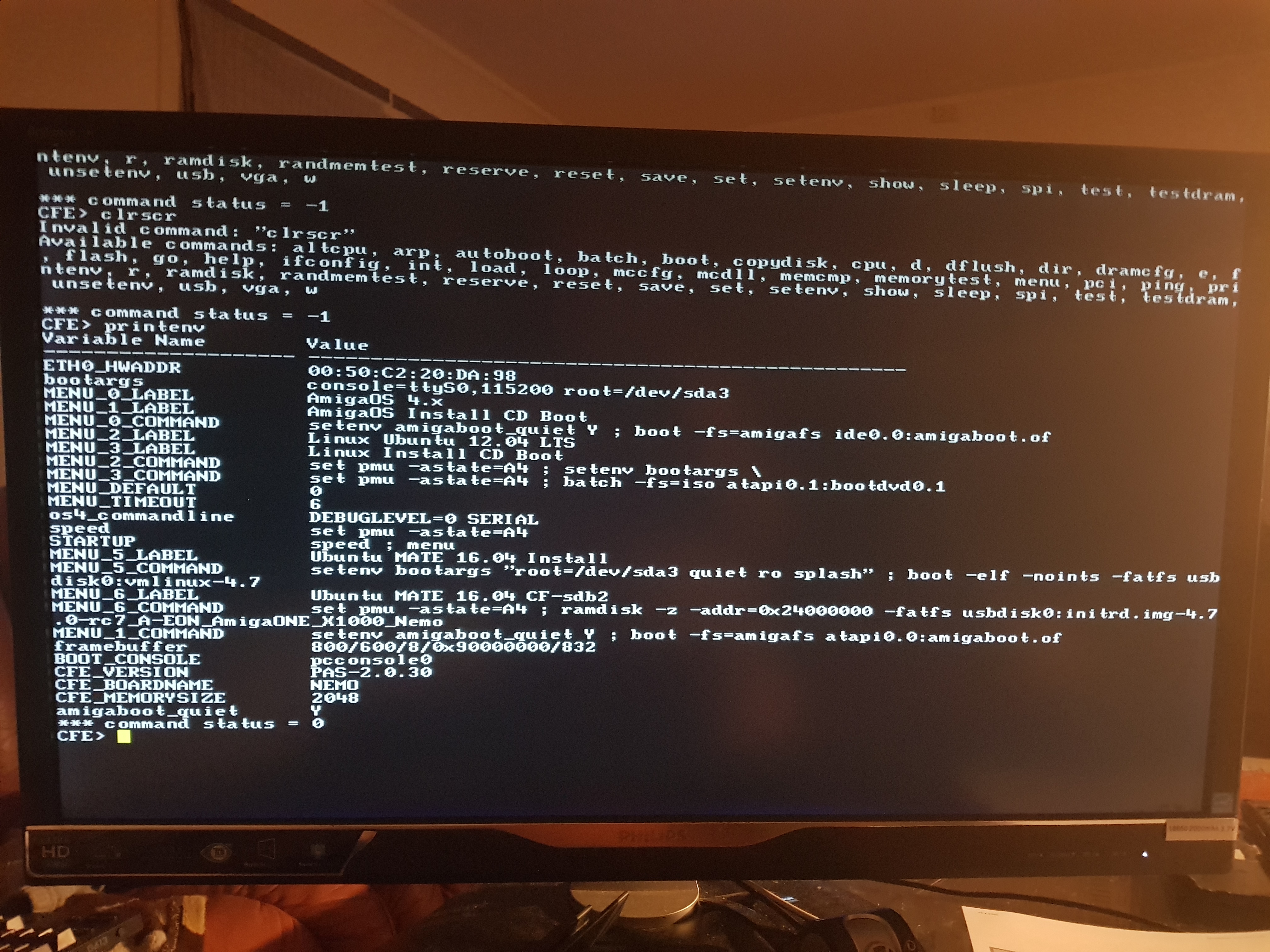

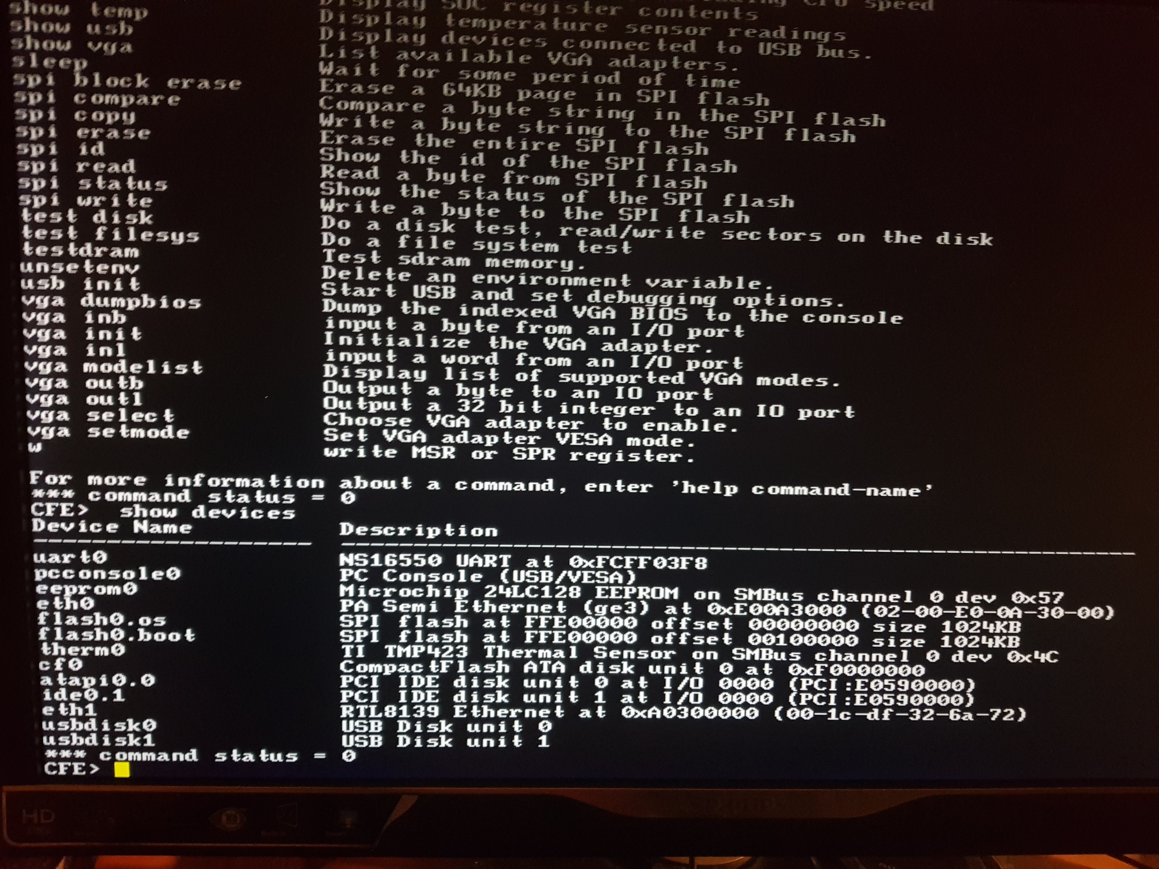

Sometimes the DVD drive isn't connected to atapi0.1 but maybe to atapi0.0. With the CFE command "show devices" in your screenshot you can see that your DVD drive is connected to atapi0.0.
Please change the CFE variable "MENU_1_COMMAND" to "setenv amigaboot_quiet Y ;boot -fs=iso atapi0.0:amigaboot.of".
MENU_1_COMMAND=setenv amigaboot_quiet Y ;boot -fs=iso atapi0.0:amigaboot.of

I can see that you have your addresses wrong:
Picture 2 shows that
ide is set to address 0.1
and
atapi is set to address 0.0
but Picture 3 shows that you´ve set up yor drives the other way round
ide0.0
and
atapi0.1
You need to switch the numbers around and it should work

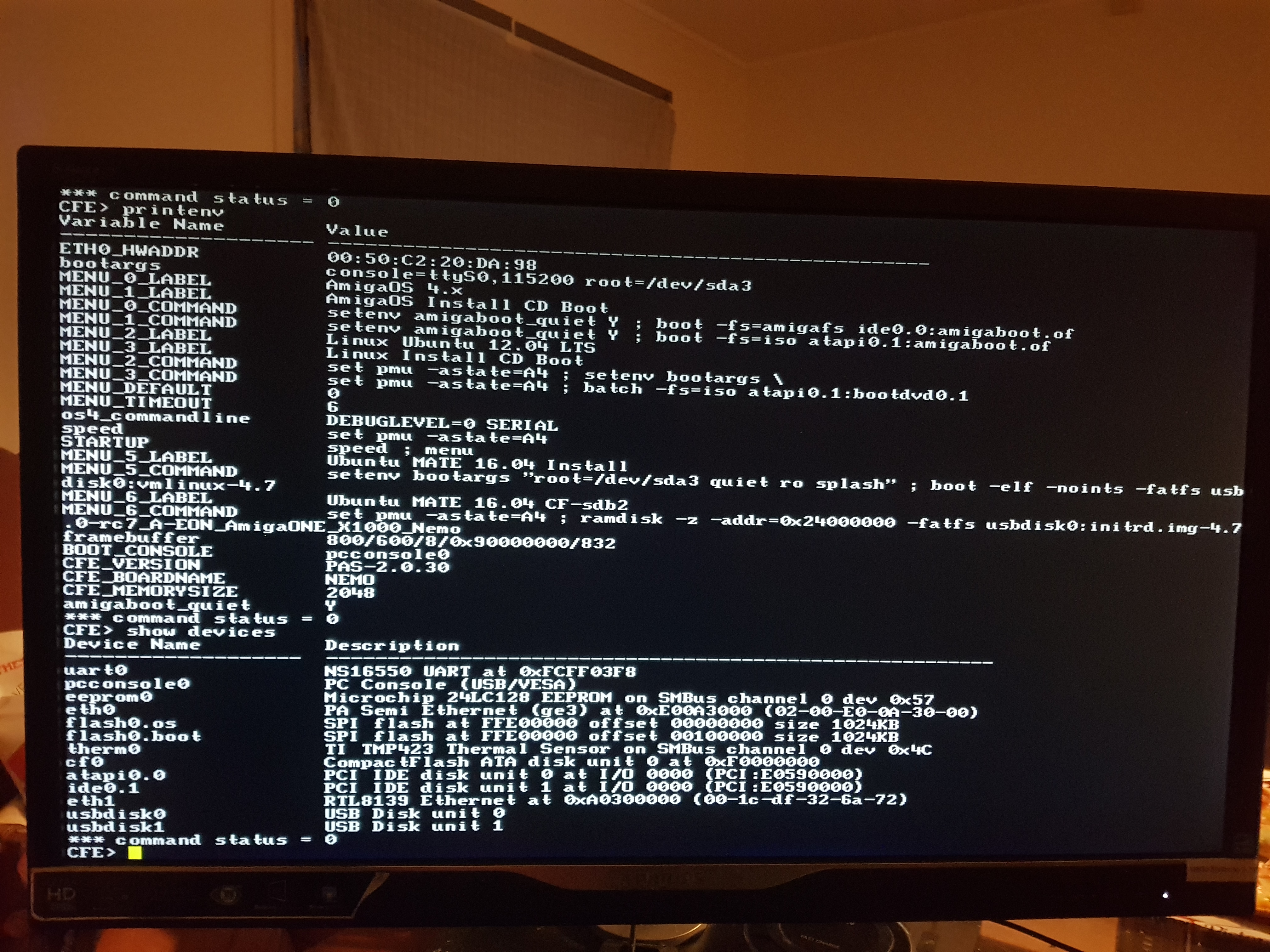

setenv -p MENU_0_COMMAND "setenv amigaboot_quiet Y ; boot -fs=amigafs ide0.1:amigaboot.of"
setenv -p MENU_1_COMMAND "setenv amigaboot_quiet Y ; boot -fs=iso atapi0.0:amigaboot.of"
edit: fixed the atapi entry

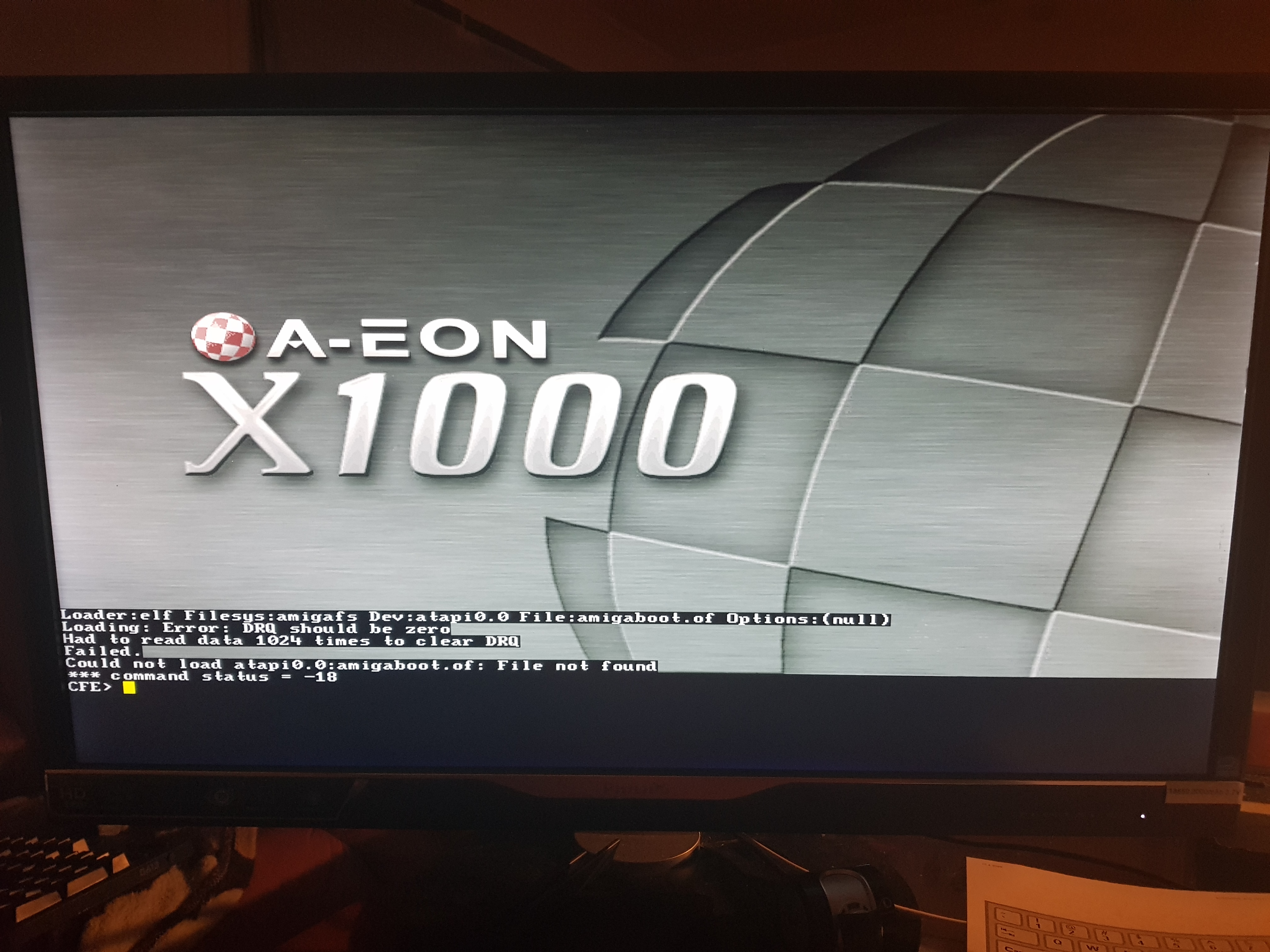

Hi again. I think i came one step closer. The first time i tried it, i heard the cd spin up. But i get this error message.

Yeah, it´s messed up.
You could try to choose the menu item 2 in the boot menu.
But in the long run it´s better to fix your CFE boot entries
edit:
ah, wait a sec, your atapi entry is wrong
You have set it to
setenv -p MENU_1_COMMAND "setenv amigaboot_quiet Y ; boot -fs=amigafs atapi0.0:amigaboot.of"
while it needs to be
I had it wrong too in my command examples (fixed), sorry about that.
The iso amigaboot.of is read from a different address, thats why it fails from the CD media
