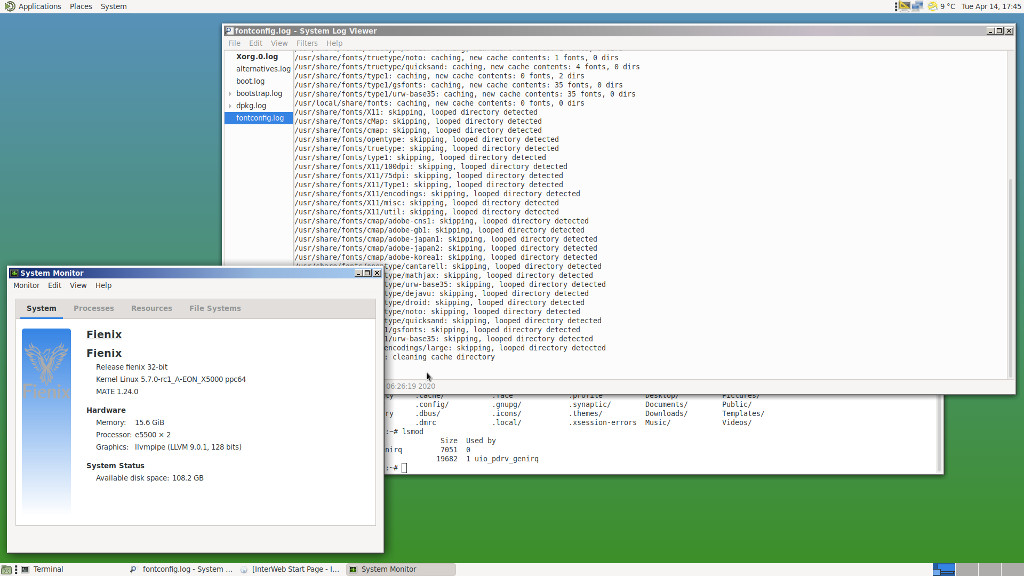

For me, Fienix boots into a black screen with a cursor prompt topleft....
Any ideas...

Posts: 11170
Skateman wrote: Mon Apr 13, 2020 3:30 pm For me, Fienix boots into a black screen with a cursor prompt topleft....
Any ideas...
I know that you have a Radeon SI graphics card.
Do you have the library /usr/lib/xorg/modules/libglamoregl.so? If yes, then please prevent the libglamor module from loading. It is loaded if a Radeon HD7xxx or above card is detected and causes xorg to crash.
sudo mv /usr/lib/xorg/modules/libglamoregl.so /usr/lib/xorg/modules/libglamoregl.so.bak
@Casey
Could you please rename the libglamoregl.so to libglamoregl.so.bak in your next img?
Posts: 972
It has been renamed to .bak already.
I have copied my Xorg.conf from my ubuntu linux to Fienix. The Welcome screen shows up... i can login as fienix...
After login the screen turns to black again... mouse pointer still visible and responsive
All is running, can switch to a different TTY and work without the GUI in fienix.
It has to be something with the display drivers..
Let me fiddle a bit more...
Big picture http://www.skateman.nl/wp-content/uploa ... -45-07.png
I found out that i can login as Root and get the "default" mate desktop!
So the issue is somewhere in the used Fienix theme..
The Xorg log is showing me this:..
