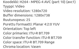

Thank you for the information! That was totally new for me... Unfortunately I cannot yet test my card with vpauinfo as I'm now away from my X5000 for several weeks :-(. The 720p video I used to get that 80% cpu usage was a MP4 one, see the attachment to see what VLC tells about it.
