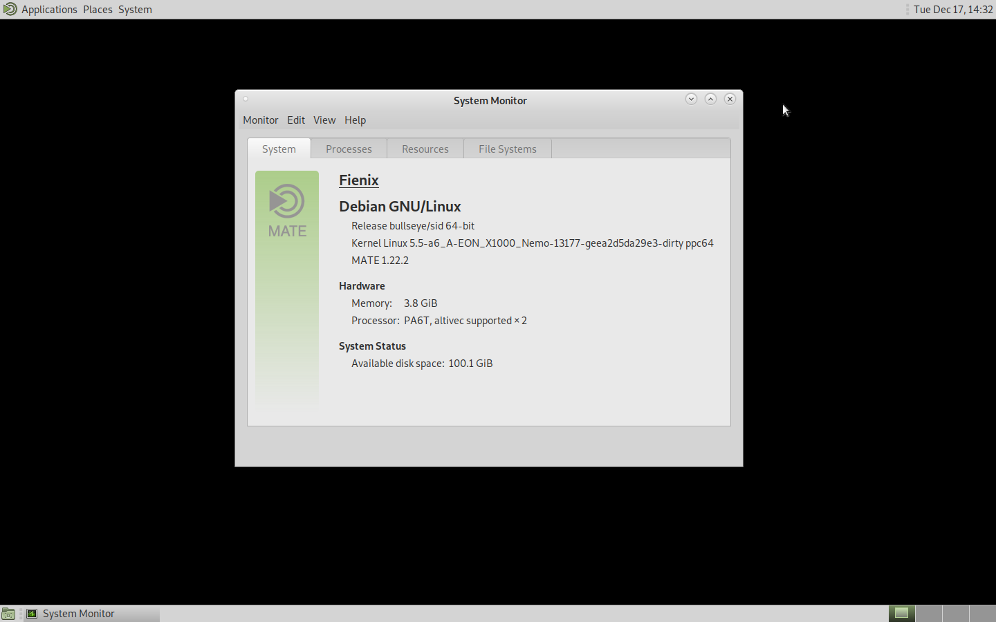

Screenshot of Fienix 2020-01 on my AmigaOne X5000/40:
Screenshot of Fienix 2020-01 on my AmigaOne X1000:
Casey, Fienix is the best and most modern distribution we have currently! The games work faster with Fienix as with ubuntu MATE! Many thanks for your work! :-)
