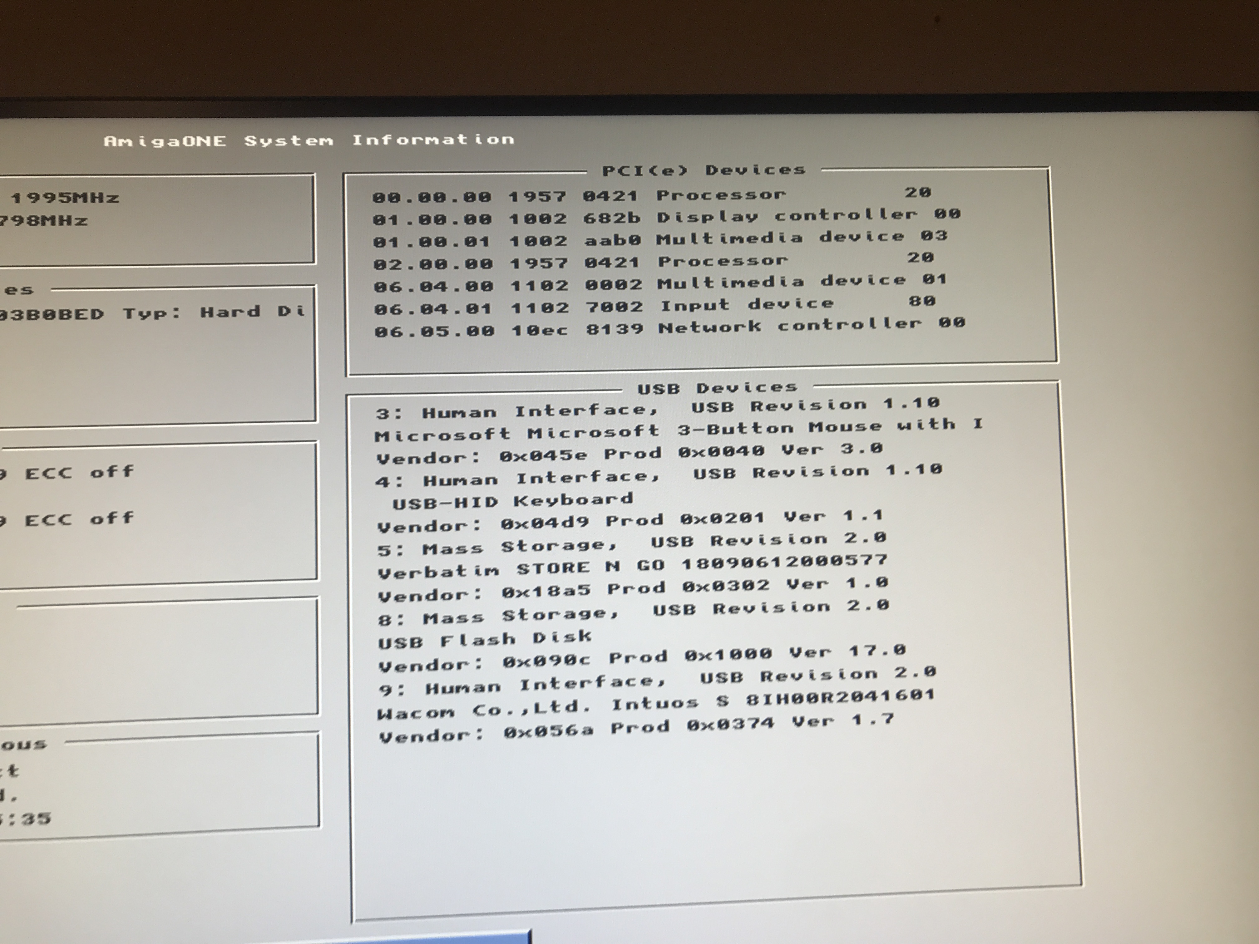

Thank you, I bought the program but tablet won’t work ,Wacom tablet , Intuos small.Great program though I emailed him about the tablet got right back to me.Made a few suggestions the x5000 was slightly problem said his x1000 none but not same tablet.He thought the tablet might be too new and he even gave me email for the guy that wrote the Amiga Wacom driver how’s that for customer service,nice man for sure .This is why I am asking for specific brands and models of tablets so as not to be buying different ones .The os4depot are not specifying what machines they are using . The one I have is an X5000.

If you are lucky yes. With no dedicated driver installed best case is that it will function as a mouse, all drawing strokes will be treated and relative movements and no pressure sensitivity. Or it might just go 'potty'.
There is dedicated wacom driver at os4depot, but from discussions else where we know it;s not recognisong this newer tablet. Best case here is that the list of IDs will just need updating, worst case is new driver needing to be written. I think Titajj has been in touch with the author of that driver ( Abalaban) , fingers crossed he can support it.

Please excuse the delay. The new tablet driver does not work .Contacted Alexandre Balaban and informed him .It shows up but does not work with tablet.
