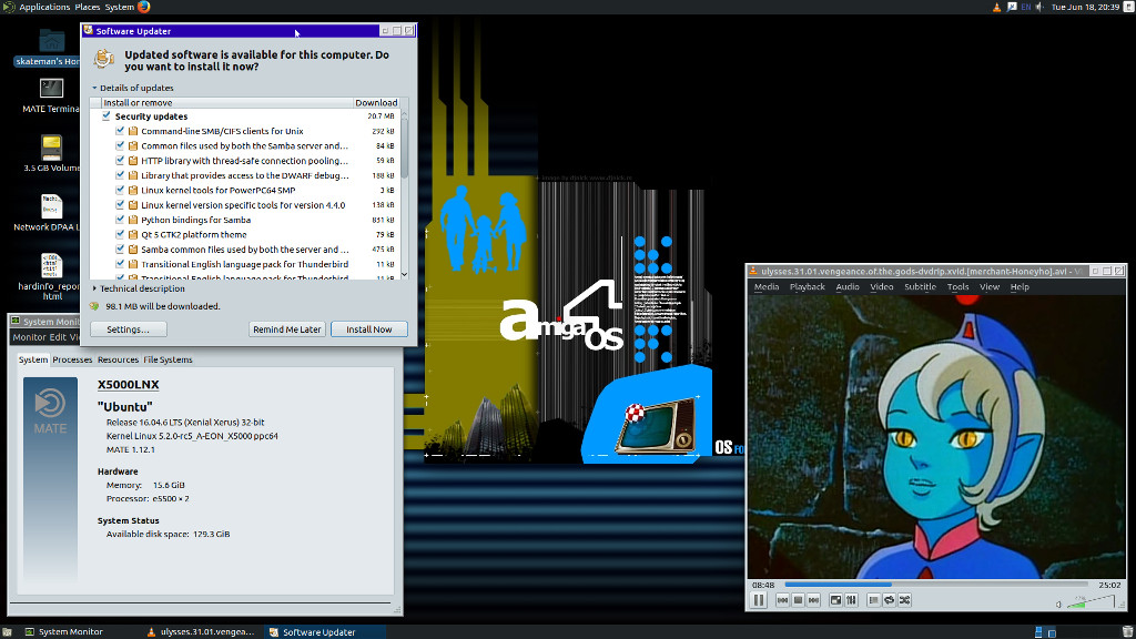

Posts: 977
Re: Kernel 5.2
Kernel 5.2 RC5 is all fine on the AmigaOne X5000
Big picture http://www.skateman.nl/wp-content/uploa ... 203922.png
Keep up the good work Christian!
Posts: 11375
Re: Kernel 5.2
Skateman wrote:Kernel 5.2 RC5 is all fine on the AmigaOne X5000
Thanks a lot for testing the RC5 and many thanks for the screenshot! :-)
