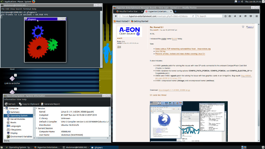

Re: Kernel 5.1
Stable Kernel 5.1.11 is running fine on the AmigaOne X5000
Big picture http://www.skateman.nl/wp-content/uploa ... 213547.png

Re: Kernel 5.1
Skateman wrote:Stable Kernel 5.1.11 is running fine on the AmigaOne X5000
Many thanks for testing the stable kernel 5.1.11! :-)
