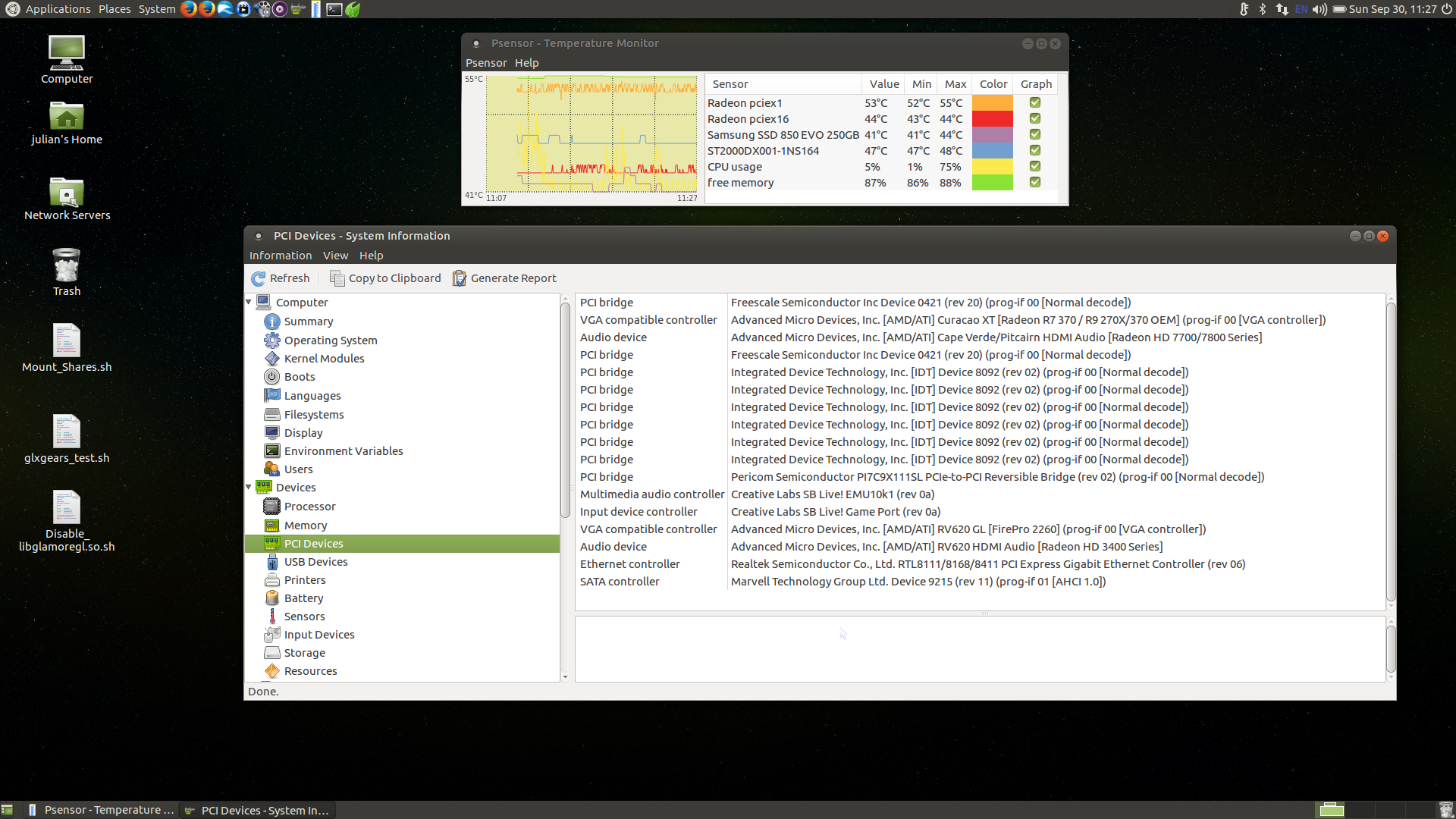

Updating configuration .
X5000 configuration information updated .
Full 3D GPU acceleration under both AmigaOS 4.1 and Linux up to supported levels under both OS'es.
Open Gl 3.3 capabilities under Linux so 3D games run including Christian's Supertuxkart-0.8-1-2 version, Caseycullen's Xonotic version and Torcs. Linux Games like xontic and Quake III work best at default resolution (640x400) see QUAKE III fps Benchmarks below
PCIEx16 = Radeon R9-270X Graphics Card
PCIEX4 = Empty (Blocked by video Card)
PCIEX1 = SATA 3 Controller (Marvel 88SE9215 chipset) for Linux Hard Drive
PCIEX1 = TP-Link Gigabit Ethernet PCI-Express Network Adapter (TG-3468) works under both OS'es
PCIEX1 = ATI FirePro 2260 Graphics Card . Primamry LINUX card (Does not function under AmigaOS 4.1FE)
PCI = Empty
PCI = SoundBlaster Live! (Using the mem=3500M command line for Linux use)
Both video cards connected to the same monitor .
HDMI Audio also possible via the FirePro 2260 card under Linux .

Re: Dual Graphics Cards
Attaching a fan to the ATI Fire Pro 2260 keeps the temperature down.
Best location seems to be at the end of the card rather than the middle.
Using a 40mm fan.
Using a 40mm fan.
