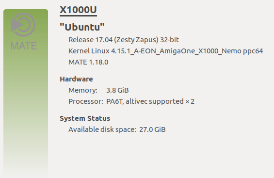

Could you also please test the first update of the stable kernel 4.15 on your X1000? Maybe my cross compiling environment is the problem.
4.15.1 boots and runs fine here.

tbreeden wrote: 4.15.1 boots and runs fine here.
tom
Hi Tom,
Thank you! Good to know that my cross compiling environment is OK. I have compiled the alpha12 for testing.
