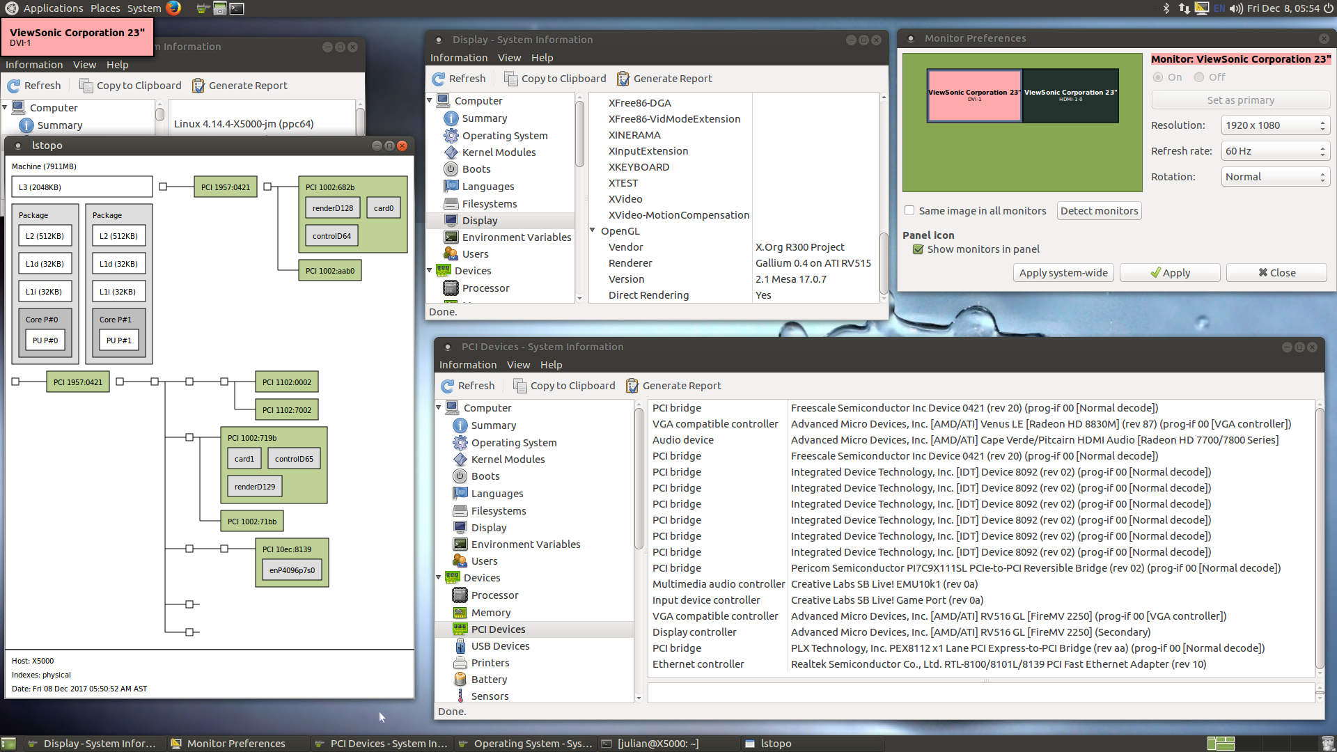

Managed to get Dual Graphics cards working under Linux and have the X5000 boot ok under AmigaOS 4.1FE update 1.
The Second Graphics card may have to have less than 1GB of ram. Possibly also less than 512MB . or thhe other device in the pciex or pci slots may not function.
Tested with cards with 256M. Have not tested a 51B card yet. May retest with a 1GB card also as I now have a SoundBlaster Live installed.
Works with a PCI Radeon 9250 or Pciex1 card. Also a pciex16 card via a PCI to pciex16 adapter (Slower Option).
Have full 3D acceleration under Linux and plus a RadeonHD SI card under AMIGAOS 4.1
So Working Radeon FireMV 2250 256MB pciex1 as second video card in pciex1 slot under Linux.
Card is RV516 so only does OpenGl 2.1 .
Games like SuperTuxKart need OpenGl 3.1 or better to work properly.
Next up to test a FireMV 2260 256MB pciex1 which does OpenGl 3.3 .
