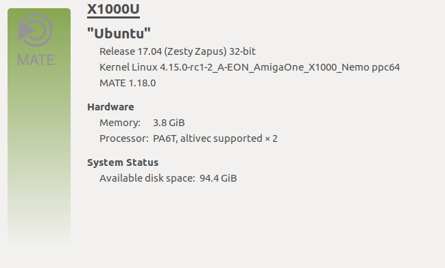

Kernel 4.15
tbreeden
Posts: 160
Re: Kernel 4.15
Post by tbreeden »
Download: vmlinux-4.15-rc1-2-AmigaOne_X1000_X5000.tar.gz
Looks good from here!
tom
