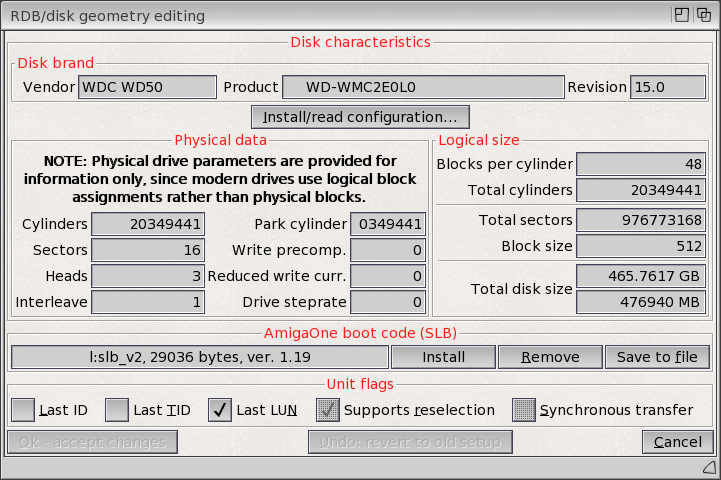

When on mediatoolbox you hit install, then on rdb editing install again you are asked to select AmigaOne boot code
= SLB—v2 ?
Preparing a new HD for installing 0S4.1 FE
Re: Preparing a new HD for installing 0S4.1 FE

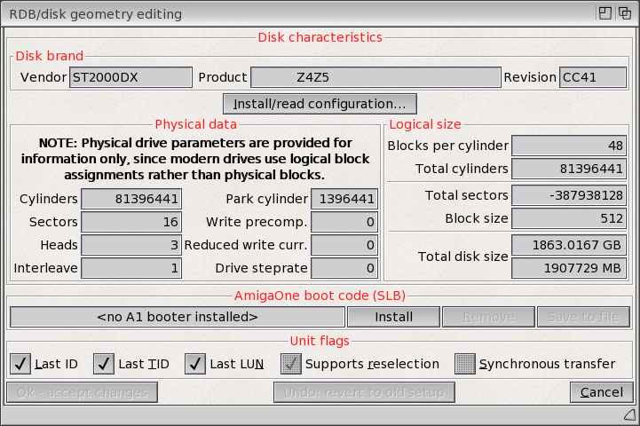

I would also like to know the answer to that for X5000. Some systems have SLB, X1000 has amigaboot.of and I don't see any boot file for X5000.JosDuchIt wrote:Guidance on this? URL?
= SLB—v2 ?

for X5000 the boot code is on the microsd card .

In that case, what do you enter for AmigaOne boot code in the Edit RDB window of MTB??Spectre660 wrote:for X5000 the boot code is on the microsd card .

The X5000 boot drive does not need any "A1 booter "so don't install anything.

As Spectre660 said, the SLB was only used on the SEs, XEs, µA1, Sam 440s and 460s. No other platform used it and it's not required in any modern machine.xenic wrote:In that case, what do you enter for AmigaOne boot code in the Edit RDB window of MTB??
