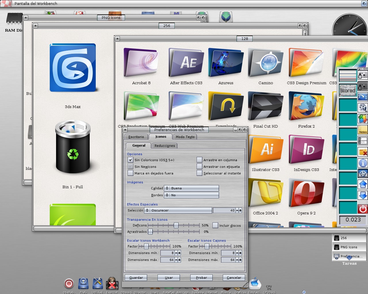

Re: Scaling Icons
I send the snapshoot of my screen.
1 window with 256x256 icons
1 window with 128 x 128 icons
and the icon preferences.
Virginio
Virginio

Re: Scaling Icons
Ah, so it's PNG icons that aren't scaling? What about standard AmigaOS icons?
Maybe the png icon module doesn't support scaling, I'm not sure I don't have it installed at present.
Perahaps convert the PNG icons into AmigaOS icons?

Re: Scaling Icons
Yes, I have the png.iconmodule.
It's the same version.
Scaling works well in my old Sam 44o Flex.
I reduce to scaling a 32x32, and don't work, it's not a png icons fault. tested in Sys ( original OS4.1 icons) and don't scale.
I found one problem more, I can display png pictures, in opus 4, and other viewers, except Fastview and Picture Viewer ( both from Enhancer pack). This gime me a DSI error.
Tomorrow make more test and publish the log.
Virginio

Re: Scaling Icons
Well.
I make a new fresh OS4,1 install in a new partition.
After that, the scaling icons works fine. The PNG icons shows like a PNG images.
Copy PNGiconmodule and the correct png1.2 so library.
PNG icons now shows well and scaling works. So the problem is in a later installation. I think it goes for the Enhanced Pack, I will install it in the new partition and comment you.
Thanks for the help.
Virginio
