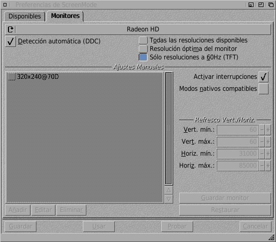

Re: Fixing screen size and internet on a newly installed SAM
See pics attached, that's how I have on my SAM460ex and Radeon HD6570, my monitor as a SAMSUNG SyncMaster 741MP (4:3).kilaueabart wrote:...
Is Radeon RV730 really the same as Radeon HD 5450? Devs > Monitors in DH0: says RV730 and even when I replaced it with the 5450, Prefs Screenmode > Monitor refused to change. Could that mean the SAM has a different card from what the X1000 has? In any event, I get full resolution vertically, as before, but not full width, even though 1280x1024 is selected in Screenmode.
About the icon in DEVS:Monitors I have/use:
Radeon HD.info
and tooltypes:
CMPLENGTH=9
BOARDNAME=Radeon HD
DDCMODE=60HZ
(VSYNCMIN=56)
(VSYNCMAX=75)
(HSYNCMIN=30000)
(HSYNCMAX=81000)
(MODE=320x240@70D)
DISABLEFAKENATIVE=Yes
INTERRUPT=Yes
DDCMODE can have ALL, 60HZ or PREFERRED as arguments. (show ALL resolutions/refreshes, only res. with 60HZ and monitor native/PREFERRED resolution)
The IMPORTANT tooltpyes are:
CMPLENGTH=9
BOARDNAME=Radeon HD
BOARDNAME (IIRC) should match icon/.info name and CMPLENGTH it's the BOARDNAME's string length. Not sure, but if those 2 tootlypes don't match (name and string length) maybe you get a 640x480 basic resolution, but that's not your case.
