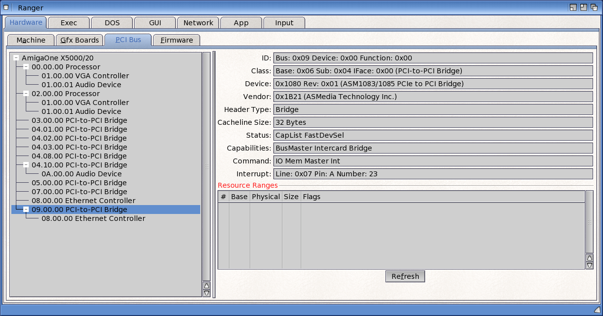

Is there some tool which can be used to check the chip revision on Envy24HT cards?
Posts: 1538
Re: Odyssey - YouTube - Offline Movies - system freezes
Ranger.
The version that works on the X5000 is a comercial version available from A-Eon's Amistore .
http://www.amistore.net/
The info from Ranger :
http://forum.hyperion-entertainment.biz ... =30#p40225
Roland wrote:
Spectre660 wrote:It is indeed an Envy24HT card.
These cards also have the bridge chip that have the problem with the CMI cards.
However based on my postings above some Envy24HT cards with the problematic version of the bridge chip (Revision 1)
may work . Mine is the only report of a version with the revision 1 chip working thus far though.
